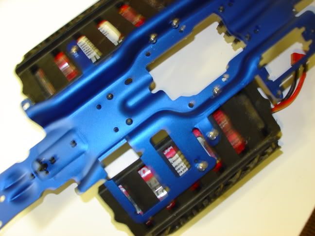

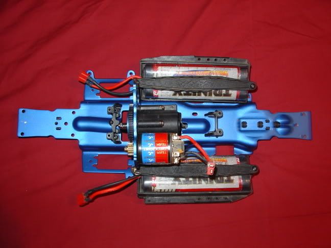

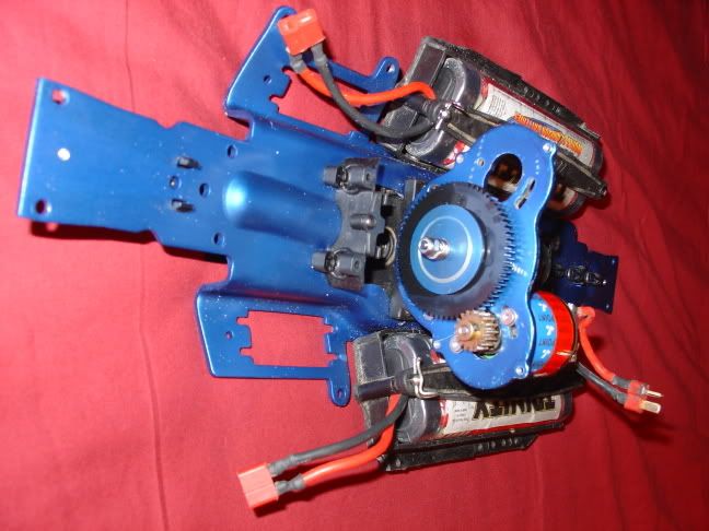

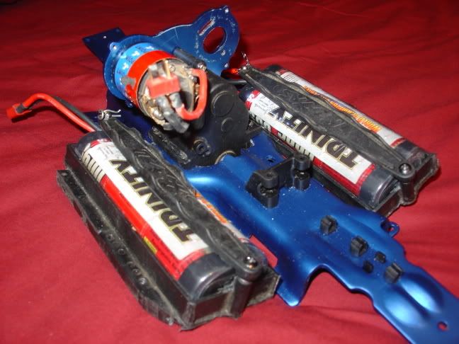

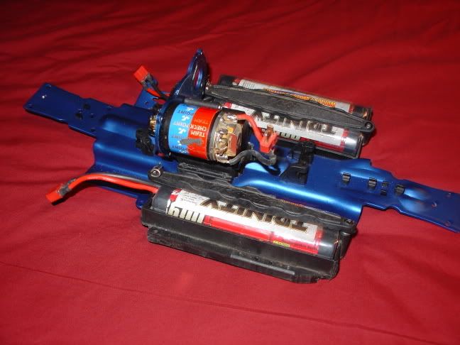

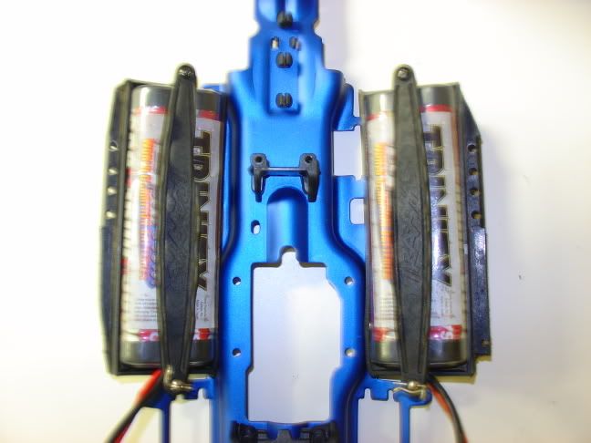

I'm juggling two projects right now, my BL Savage and my Revo. I have a stock nitro revo that will become electric once the engine dies. My Dad had an extra stock Revo chassis, and I had these hacked up battery trays from my Savage and I also had an E-Maxx tranny. To save time I started converting my Revo now, so as soon as the engine dies I can drop in this conversion. So far I have the battery trays and tranny done. Does anyone know if the stock sliders fit on the e-maxx tranny? Hope you enjoy!

ttrmike 11.03.2005 11:00 AM
The front slider will not fit, so your going to have to pick up 2 rears. also your going to have to do A LOT of grinding on both sides of the tranny on the chassis.
E-Traxxer 11.03.2005 11:07 AM
Do you mean to fit the tranny on the chassis I will have to grind it out? If that's what you are talking about, I've already done that and fitted the tranny. Or do you mean to fit the sliders on, since the output shafts are close to the chassis? Oh, and do the Revo sliders fit on the E-Maxx output shafts? I'm probably just going to get dogbones made, since I'm going to have some big power in there soon.
ttrmike 11.03.2005 11:22 AM
You will have to do a lot of grinding to get the revo sliders to fit because of the e clip on the u joint, you also have to grind down the e maxx output shaft for the revo sliders to fit. I think you should just go get the dogbones casue you won't thave to do any of the grinding I mentioned.

squeeforever 11.03.2005 07:26 PM
its actually pretty easy to get the revo shafts to fit. all you have to do it grand, sand, file, ect. on the ends of the slider. there is a sholder that needs to be removed for it to fit on the e-maxx trannny. also, as ttrmike said you will need to rear.
