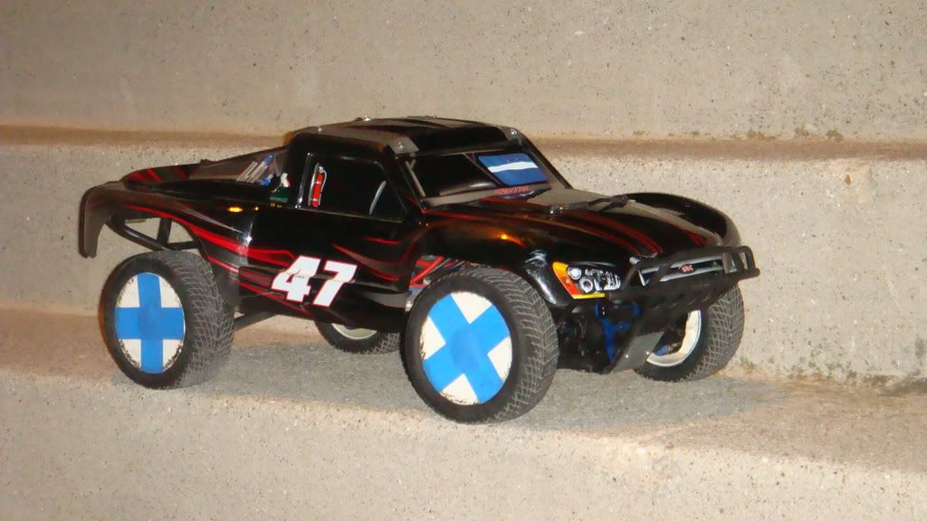

I think we are talking about street tunning? or dirt? 17 MM buggy dish. [IMG]http://i300.photobucket.com/albums/n...d/DSC03933.jpg[/IMG]
xcntrk 09.15.2008 04:09 PM
Well there you go ;)
