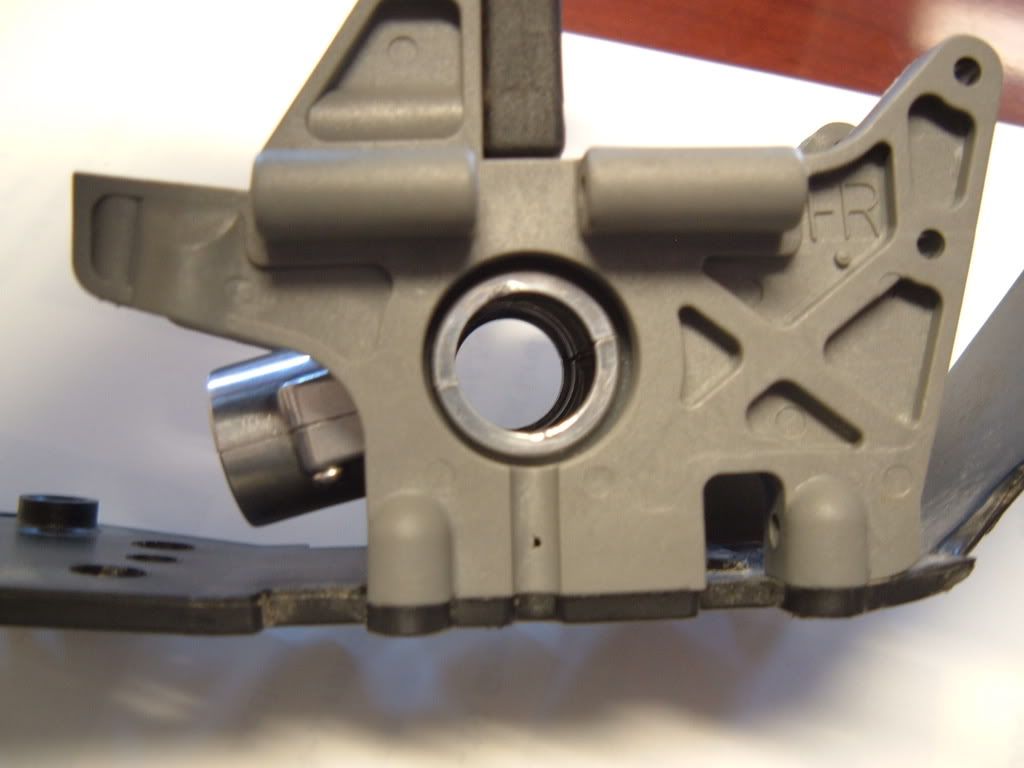

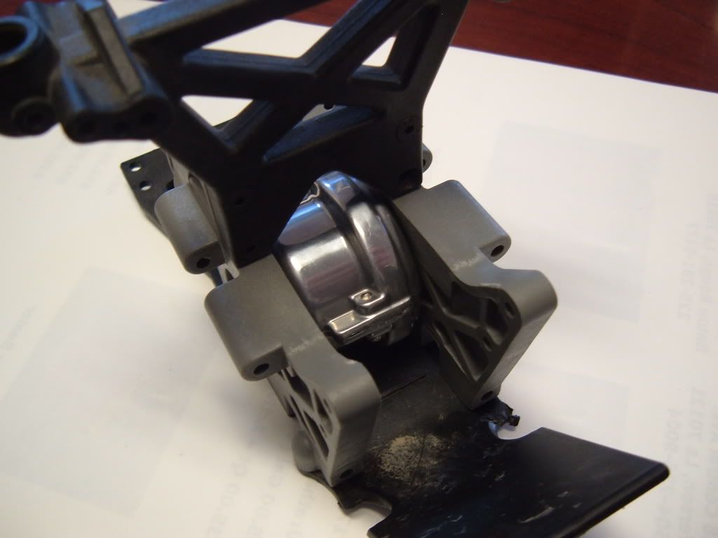

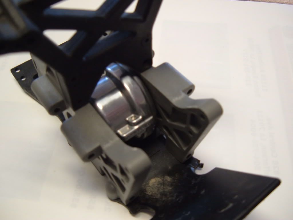

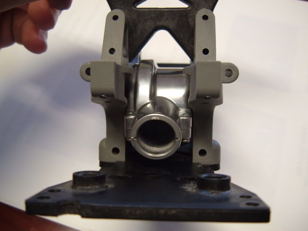

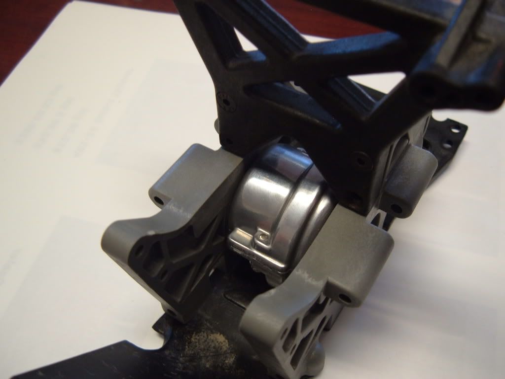

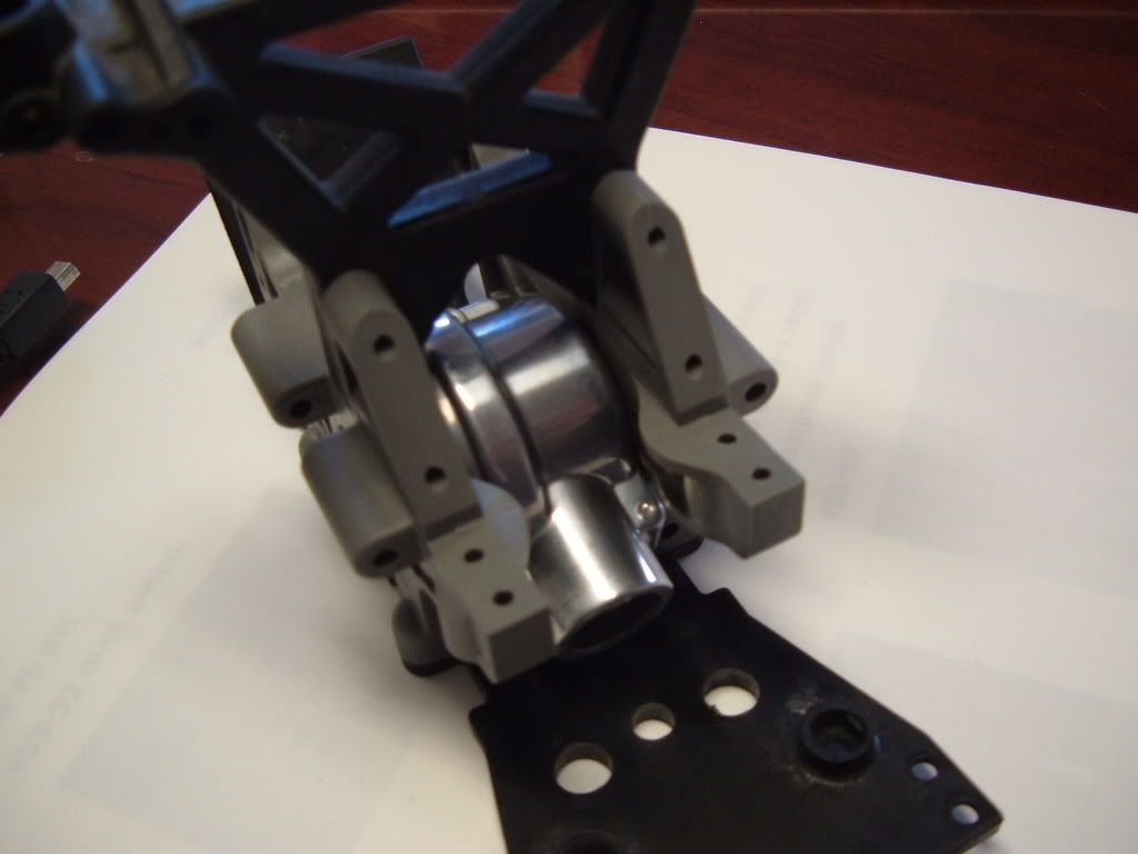

Next project. So this has been done by a few members here before, including me. I did not care for the method by which the diff was held to the bulks. So I did some measuring and some material sourcing. Found some great thermoplastic that I could make the adapters out of. It is of similar material to the stock bulks. I was going to use al, but decided that plastic would be easier to machine, lighter and allow some flex. Here are some pics of what I have so far. I am waiting on the al front collars so that I can mod them to work. The bulks will have to be trimmed slightly to accomodate the wider nose of the LST diff case. Not much material to be removed, and can easily be done with a dremel or hobby knife.

Hopefully this will provide an alternative to the FLM hybrid bulks. Losi offers a variety of diff gears and cups, along with plastic and al cases. My intention is to test this setup extensively and possibly offer the components to anyone interested. I should have more info after I receive the front case collars.
brushlessboy16 09.24.2008 05:42 PM
so many innovations lately linc, looks very nice- how will they hook up to the stock slider shafts though?

Don't worry, got all that figured out. Plus I have methods to attach any type of CVD as well. Wait until you see all of the diff options, this is definately the best bet in heavy duty diffs...
