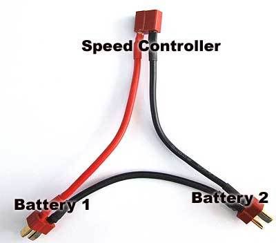

I was wondering if someone could please tell/show me how to make a couple adapter plugs:
1. Adapter to wire two batteries in Series.
2. Adapter to wire two batteries in parallel.
Thanks,
Thomas
jayjay283 09.29.2008 10:08 PM
series, someone else can parallel, too lazy
http://i274.photobucket.com/albums/j...raxxas_Ser.jpg

hoovhartid 09.30.2008 01:57 AM
parallel;
http://i87.photobucket.com/albums/k1...sam/HXT-PC.jpg
http://www.hobbycity.com/hobbycity/s...idProduct=2155
series;
http://i87.photobucket.com/albums/k1...sam/HXT-sc.jpg
http://www.hobbycity.com/hobbycity/s...idProduct=2156
for higher powered systems, I recommend thicker wires;
I use this for my MMM;
http://i87.photobucket.com/albums/k1...m/IMG_1401.jpg

So how about a triple? All my packs are 2S2P A123's, and I was thinking last night that I might want to have the ability to run 3 packs (to get 6S A123), but then normally I would only run 4S. Can it be done with a jumper wire on the plug that isnt being used?
BrianG 09.30.2008 09:38 AM
Of course. You can have as many series or parallel packs as you want. For 3 packs in series, go here and select the correct option
JThiessen 09.30.2008 11:16 AM
I was more wondering if I could use the same harness when I only run 2 packs, and just plug a jumper across the spot where I'd normally have the third pack. Seems to me that it would work.
BrianG 09.30.2008 11:29 AM
Yup. Just use a Deans with the terminals bridged...
