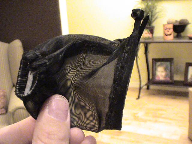

Ryu James 10.08.2008 11:10 PM
3 Attachment(s)
what i did to cover my endbell on my 1.5D/Fs was i took some of the foam stuff that comes in the packaging with Traxxas hop-up parts and cut it out to the size of the endbell then drilled 3 holes slightly smaller than the wires. this way the foam secures tight around the wires and does not allow any dust in. also this helps to hold the foam tight against the motor. finish it off with a little electrical tape and this has worked fine. never had the stuff melt or anything and it looks real clean. i havent even had one person notice that it was there. it just blends right in. also, Outerwears makes some little net filters that are specifically made for the endbell on Neu motors. i found some on ebay and have used those too but dust can get thru those. i since have used them over the top of my own contraption for extra safety. you can see in the pic they just zip tie on and have an elastic on the other end to hold tight around the wires.
