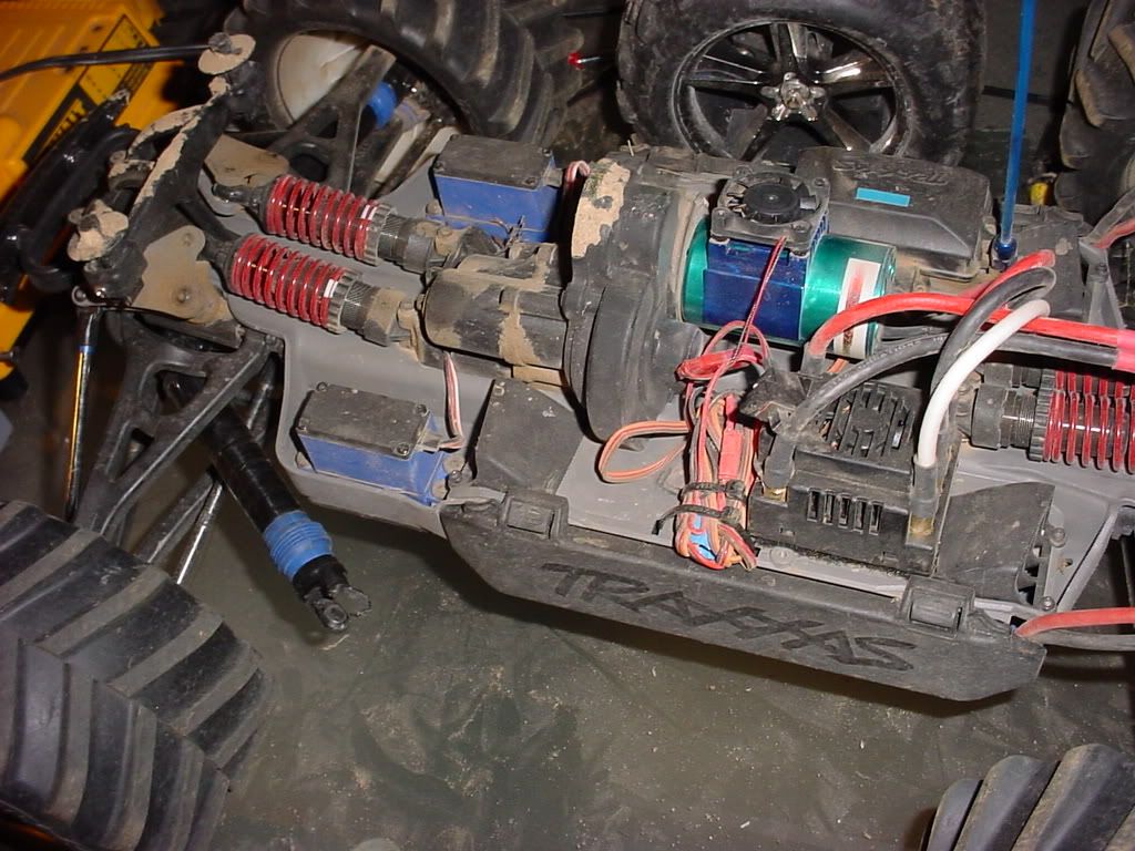

Hi Guys,
Many Thanks to Linc for such a fine motor.
I installed this Medusa 36-60-1500kv in my E Revo. Realizing the lower Kv multipole motors make more torque than their high revving 2 pole counterparts, I decided to go with the same gearing my AXI 2826/8 motor had been pushing around. The gearing is Mod 1, a 22 tooth motor pinion and a 40 tooth Nitro Revo spur.
Now this is some pretty high gearing, so I figured it best to keep an eye on temps.
Maiden voyage for my Monster Mamba using this setup. I LOVE this ESC. No problems thus far. She's running like a champ. I love it.
First run was on 4S 20C 5000mah Lipo. Performs very well. Temps were well in hand even without a heat sink.
On 6S, it's impressive. This little motor REALLY puts out some good power considering the gearing. According to Brian's Speed Calculator, on 6S, this is geared for 60mph.
6S operation is what made me install the fan/heat sink on the motor. Without it, temps would get out of hand pretty quick. I ran it for about 10 minutes without and decided I better stop.
6S operation is good with the fan/heat sink installed. The ESC is more stressed as the fan cycles on and off, and seems to be stimulated by WOT runs. LOL I think my pair of 3S Lipo's have just about had it. It was getting on the LVC about halfway through the run. They are about a year old now though and have seen alot of abuse. I know I overamped them several times on other setups. What's a good set of 3S Lipo's to go with for the E Revo? I'm looking.
Sorry for the gob of wires, but there is a CC BEC in there programmed to 7 volts running the fan only. Servos and Radio are both being powered by the ESC.
I'll do some more runs and testing tomorrow. Perhaps 5S is the sweet spot for this setup.
Here's a pic.
http://i160.photobucket.com/albums/t...m/DSC07192.jpg
BL_RV0 10.17.2008 10:13 PM
:yes: Looks beastly!

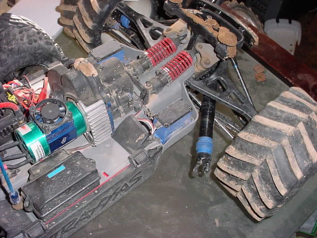

I decided to make a run this morning on 4S. I was thinking "Wow, this is really doggy compared to the 6S."
Then I hit WOT in reverse for a few seconds and noticed it was much more powerful. Duh!
Now I feel stupid. The Throttle Channel on the Radio was reversed and it was running around programmed for 50% Reverse.
After swapping two motor wires and reversing the Throttle Channel, things REALLY came to life! Perfect on 4S! Motor temps well in hand with the fan/heat sink, but now the fan on the ESC was cycling on and off.
Well I had to try it. 6S! Now it's a different beast entirely. Tire Ballooning, rolling wheelies and increased temps.
Continous operation would overheat the motor. I'm going to enlarge the heat sink area on the motor and possibly add a second fan.
It will go from 0 to uncontrollable in about .5 seconds.
My run was cut short when a drive shaft gave up! Can anyone say power? LOL
http://i160.photobucket.com/albums/t...m/DSC07195.jpg

sikeston34m 10.20.2008 07:23 PM
Well I got the front right drive shaft replaced with a new one and decided to have some fun again today.
I got almost two runs in. First run was on 4S2P of the 2500mah Sony 26650 cells. The run lasted about 30 minutes and was alot of fun. The Batteries were a little warm at the end of the run but did perform really well.
Second run was on 4S 20C 5000mah Lipo. I can tell the discharge curve is flatter and they hold voltage under a load better. Rolling wheelies, Rooster Tails of dirt and gravel. It's alot of fun. The hottest I seen the motor on 4S with this gearing was about 135 degrees. I can live with that. The thing is a Torque Monster and tops out about 40mph.
BUT.............back to the drawing board here. About 20 minutes into the second run, I discovered how to throttle it and make it get up on it's back tires and walk. It's really funny. I can save it most of the time too. :yes:
But obviously, I either got some weak factory driveshafts or this kinda thing is pretty hard on them. The other front driveshaft blew out the side this time.
I'm really happy with the ESC and the motor though.
http://i160.photobucket.com/albums/t...m/DSC07197.jpg

brushlessboy16 10.20.2008 07:45 PM
wouldnt you think that the rear shafts would take more abuse? i wonder why the fronts are blowing
david lamontagn 10.20.2008 07:50 PM
sikeston34m , i can see on your pics that you don't cover the cooling holes on the back of your motor:surprised:
I'am not sure that your investment while last very long.
The sand who'll go between the rotor and coil while short something very soon, so put duck tape to cover the holes and bearing, and place some drop of boostix (hot glue) around the output wires.
Your motor will thank you:yes:
sikeston34m 10.20.2008 07:52 PM
I can only imagine how powerful the Neu motors are. I haven't stepped up to that plate yet. LOL I do foresee a Castle Neu in my future. I do desire it, so I will acquire it. LOL
Yeah on the rear driveshaft thing. That's what I was thinking too. But when I raise it up to "walk the dog", it goes side to side, then I hit the throttle again right about the time it comes down. This is what I was doing when this one blew.
I could loosen up on the slipper a little, but that's no fun. LOL
