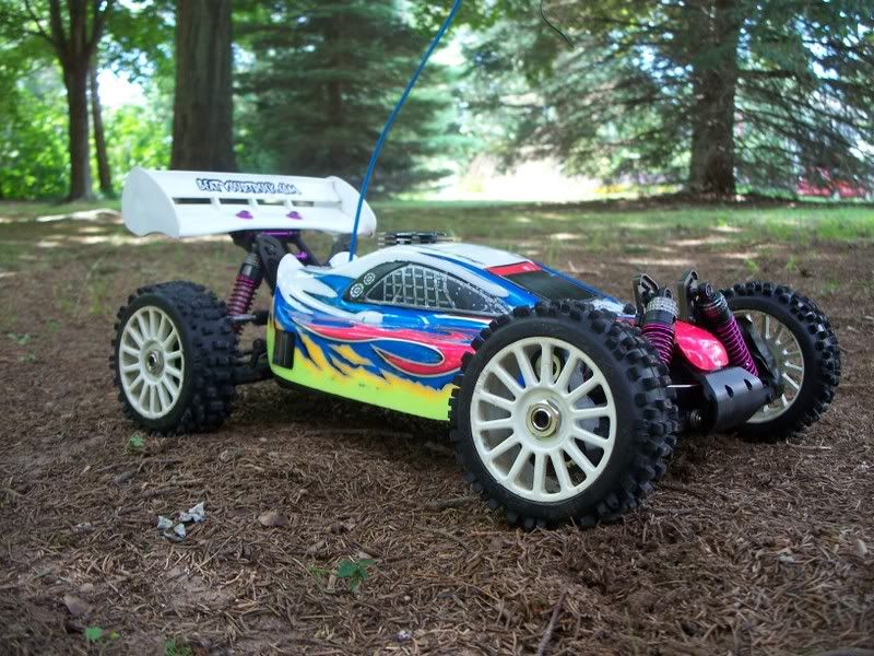

Hey guys,
I am looking to convert my Hyper 7 pbs to BL as the Nitro side of things is dying on me. Its just too much of a pain. Anyways I have been doing some research here and on other forums and have come up with a general idea of the setup I want. I just want to see what you guys have to say and if there are any tips / hints / ideas that you could give me to steer me in the right direction.
Heres my hyper as of now...
http://i99.photobucket.com/albums/l2...2/100_3409.jpg
The setup I am leaning towards is this:
ESC- MM (b/c I already have one)
Motor- Feigao 8,9, or 10xl
Mount- Novak BL conversion (I would go RCM, but I like how it already has the battery boxes)
CC BEC
Any info from you guys would be great, seems like a really great forum here.
