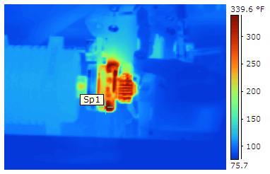

Chuck67 11.09.2008 06:12 PM
1 Attachment(s)
Heck 150 °F is nothing try 374.4 °F. I burned the s&%t outta my finger!!!!
Chuck

brushlessboy16 11.09.2008 08:51 PM
Chuck
I saw this pic over on RcT but couldnt find the thread- did you ever find out why it happened?

Anyway, just for shit and giggles, I went ahead and tightened the clutch nut and slipper clutch. I went downstairs for a test run and after 1 minute, the temp shot up to 346*F. I didn't have my camera so I hurriedly went upstairs(I live in the 8th floor of a high rise towerand I used th elevator) and by the time I check the temps, it was already down to 158.5*F. It was smoking a bit when I was downstairs. The air temp is about 48*F too.
Tell you what, it still wheelies. It almost flipped too since I ran it on 6S :intello::whistle::whistle:.
Here's a pic. You can see the melt marks on the spur.
