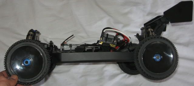

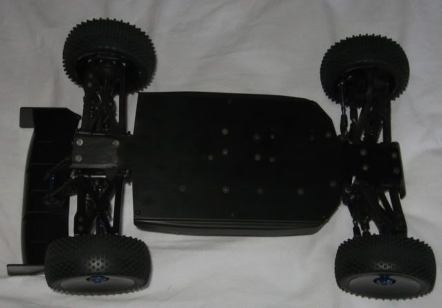

here is my new project , it will have a neu 1512 2.5d and run on 4 and 5s with a Mamba Monster , mostly track duty
i will be getting the RCM chassis once available:yes:
the top plate is homemade form aluminum and painted black to blend in , also fitted the plastic piece on top to look pro:lol: , it may need to be trimmed alittle to fit a finned motor in there , but it is close for now until i get my motor:wink:
sounds like there may be enough of us electric guys to run the indoor races this winter so i had to get a buggy and ditch the e-revo:rules:
thanks for looking
the first pic is a mock up with a rx pack , my MMM wont run with out it until i send it in , the last two pics are its current stage

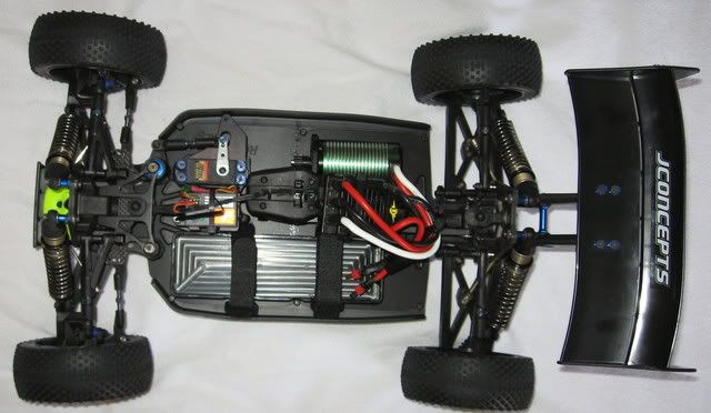

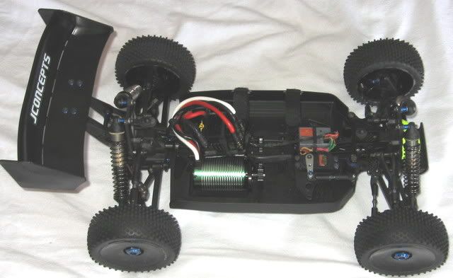

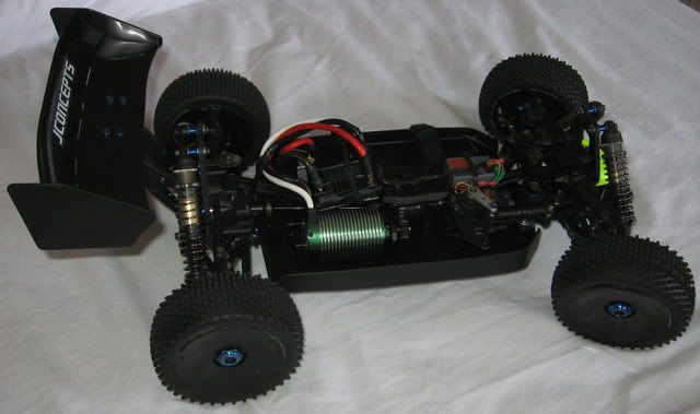

well after a long wait i finally got to order the rc-m chassis and a 2650kv motor to go with it , ill post up some pics when they get here , i am sure they will get here quick as Mike is the best
entjoles 02.20.2009 09:01 PM
parts were here yesterday, i will get to it tonight once my beer gets cold , pics later........if i dont pass out.....
entjoles 02.21.2009 12:29 PM
here it is , thanks to RCM for a great product , the only issue i have with this build is the motor , its very tight , the mesh is purfect but i can spin the front tires and the rears will spin as well and the motor wont move , those magnets are strong
Chassis = ***** 5 Stars
i also had to use the 44t spur , the 46t plastic i had seemed to rub , and i know the diff was a little wet when i tested the motor so i made a mess ;)
geared 14/44 on 4s for about 38.5 mph
i used the center diff plate i made as i didnt want to paint Mikes
i will also shorten the wires once i get a good soldering station
thanks again RCM, on with the pics
