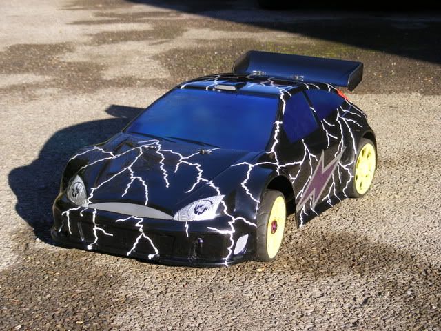

Hi folks, I'm looking for some funky rims for my on road buggy, I run medial pro tarmac II tyres which come on horrible yellow wheels, which was just about acceptable for the awesomeness of the tyres when I was running the stock buggy body, but now I have a cool body I want cool rims too, I am after something with at least 5 spokes preferably more and either black or silver (yes I mean silver not chrome) although black spokes and chrome rims would be quite cool.
The best I have found are black ofna 5 spokes, I got a set and put proline road rages on them and was utterly disappointed with the tyres, the wheels are OK and if no body can suggest anything else I will rip the proline marshmallows off and put the medial pro tarmac IIs on them, but I'm sure there are funkier rims out there for those that know where to look.
Excellent tyres, nasty wheels
http://i22.photobucket.com/albums/b3...l/1fd5676d.jpg

Nice car by the way - what is it?

The buggy is a Hot Bodies Lightning 2 Pro, hence the paint scheme and the body is a Mantua Models Ford Focus, do you not have the focus in the states?

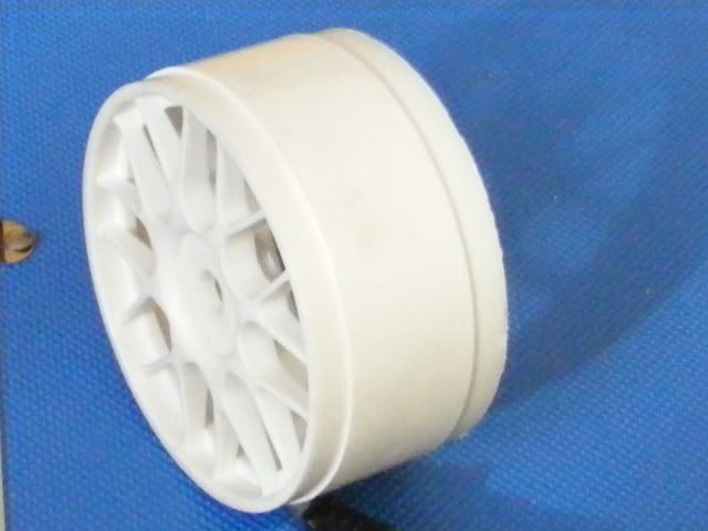

We don't seem to have Rit over here, there is a commonly found dye called dylon, I thought that may be the same stuff under a different name and bought a set of white Hockenheim style wheels to dye black but it didn't really take at all, I don't know if dylon wont work or if the wheels are made out of a non-porous plastic, I'll post some pics of the results after work.
nativepaul 11.25.2008 12:21 PM
Does Rit work on all wheels? if not has anyone tried it on the ofna wheels? I found a skate shop that sells it.
Here is a picture of the wheels I boiled for about 45 mins in black Dylon, the spokes and very edges of the rims look slightly sooty, I since read on the Dylon website that despite the similar sounding name, Dylon wont work on nylon or most other synthetics.
http://i22.photobucket.com/albums/b3...l/25421d2d.jpg

Rit will work on ant plastic or nylon wheel. to get "black" takes time and patience though. you will want to boil water, remove form heat, add rit dye, throw the wheels into the dye mixture for about 45 minutes, and repeat the process, otherwise you end up with a washed out purple color.
Black is te only color that requires a double dip and 45 mins each time. other colors take much better.
