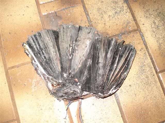

I was trying to charge one of my 5S 4000 lipo's which had been damaged previously from something.
I thought it was all good though...........little did I know.
While it was charging on the loungeroom floor, I was watching TV & heard a crackling noise & when I looked at it it was puffed up like a balloon. I grabbed it & threw it out on the verandah where it got hotter & hotter till it caught fire & threw a flame out up to approx 5-6 feet.
Unfortunately I missed recording the fire & also missed the action with pics.
Here's the end result.:whistle:
http://i55.photobucket.com/albums/g1.../Lastnight.jpg
traxxasbasher13 11.28.2008 08:59 PM
Dude that sucks. What brand was it. Mah?
brushlessboy16 11.28.2008 09:01 PM
Ouch mozzy. Looks like a charred book.
dirt101 11.28.2008 09:02 PM
do you know what damaged it...a lipo fire is like the scariest thing to me, because during the winter I charge mine inside the house...I need an ammo case.
Mozzy 11.28.2008 09:13 PM
It was a Zippy.
I think I damaged it making it draw too many amps one day when I fried my Quark.
The other 4 Zippy's I have are perfect.
This one actually had a hole in one cell, I'm assuming the hole was a vent & the pack was damaged that way. I tried charging it on a balancer & it wouldn't work, so, I charged it without the balancer.
Word of advice, always use a balancer or balancing charger & if it won't charge it, don't make it or you may lose more than just a pack! :lol:
I'll be buying another one. This hasn't deterred me from getting Zippy as it was my fault not the battery's.

Ouch... If you knew there was a hole in the cell why did you charge it? You probably could have sent the pack to james and had him remove the damaged cell.
Mozzy 11.28.2008 09:26 PM
Well, even though it had a hole in it, I'd charged it once before & it accepted the charge, soooooooo, naturally, I tried again with an unfortunate result.:tongue::lol:

Mozzy 11.29.2008 07:16 AM
Yeah, funny about the hole in the cell. It still worked so it was good to me. hehehe, I guess not!
Definitely glad that I'm not one to panic when things go wrong. Saw the pack 3 times it's original size, walked over, unplugged it, picked it up by the lead, took three steps to the front door & tossed it out onto the tiled verandah. Laa dee daahhh, all good.
Then the fireworks show followed. :lol:
