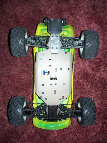

GREYGHOST 02.10.2009 03:30 PM
2 Attachment(s)
Originally Posted by yourtheman (Post 255458)
i got the frame rc monster so the body stock doesnt really fit on (if somebody say yes then tell me how) and i want run my crt .5 with the wing but if i put a T4 body then i will have to remove it....
anybody got idea wich body i can fit? i hkow a B44 can fit but i would like prefer a stock body crt .5....
thx!!
Most 10th scale bodies will fit with a little trimming here and there,now you are as long as a 10th scale and you have a world of bodies to choose from. Here's mine on the ofna xtended ,stock body.
