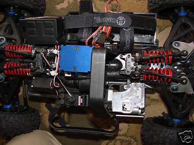

E-vil Maxx 01.27.2009 01:50 AM
Here is a couple pics still have a ways to go
http://i39.photobucket.com/albums/e1...Picture379.jpg
http://i39.photobucket.com/albums/e1...Picture380.jpg
http://i39.photobucket.com/albums/e1...Picture381.jpg
E-vil Maxx 01.27.2009 07:20 AM
Just ordered 2 long pinion 22mm in length 13 and 15tooth, should line up perfect, bye clutch bell:tongue:

3 Attachment(s)
I think going with Mikes motor mount is a sensible option over the long run.
