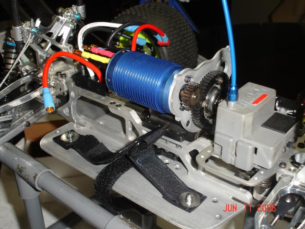

On the battery straps, the 3/4" ones broke on me, the 1" ones were strong

1. You can buy the straps from Gorillamaxx or RCmonster or you can cheap out by making it yourself. I made mine.

About the straps with Lipos the gorillamaxx straps will do their job. But if using some other brand like a123 shotgun shape (like I do in my g2r) no go.

I stole Hardstyles Idea and ended up using bike inner tube.
It seems to be working like a charm...

I just doubled up on the gorillamaxx straps, couldnt find anything with the right type of mounting style, and inner tube idea came along after I had already done the order.

I made my own battery straps. I sew it together to make the loops on both ends and bolted it down to the chassis I also made. It only cost me $4.00.
