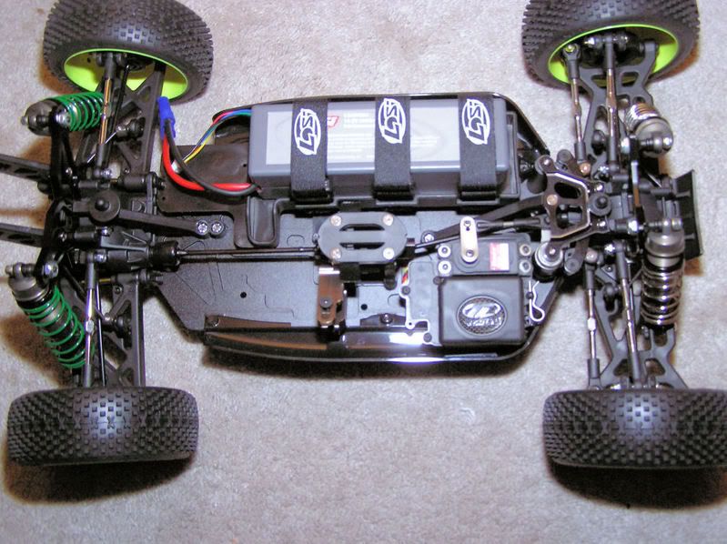

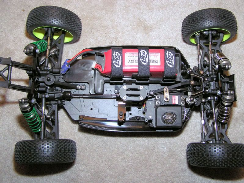

Another update: I have added the radio tray and steering servo, optional aluminum servo saver arm, losi servo horn and a King Headz steering plate. I have a Losi hard case battery in the first picture, it's a pretty big battery much bigger than the Neu or Zippy.

Losi battery
http://i142.photobucket.com/albums/r.../P1010023x.jpg
Neu battery
http://i142.photobucket.com/albums/r...P1010026-3.jpg
Losi on top, Zippy in the middle Neu on the bottom all are 25C 4S lipo's.
