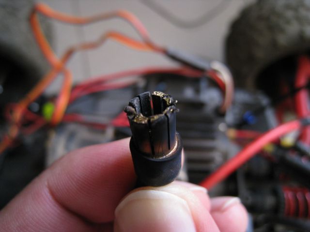

I had a brain fart and hooked up 6S in reverse polarity to my MMM V2. Loud hollow sounding pop, very bright blue spark, and a mangled connector. So the obvious question is, have I killed it? I've attached a photo of the fried connector.

Please can anyone tell me if it's okay to give power (with correct polarity) to the unit? It was just one half of the edge of the connector which touched, and the ESC itself did not emit smoke nor the familiar odour of burnt plastic/ozone.
