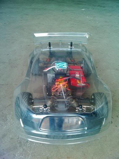

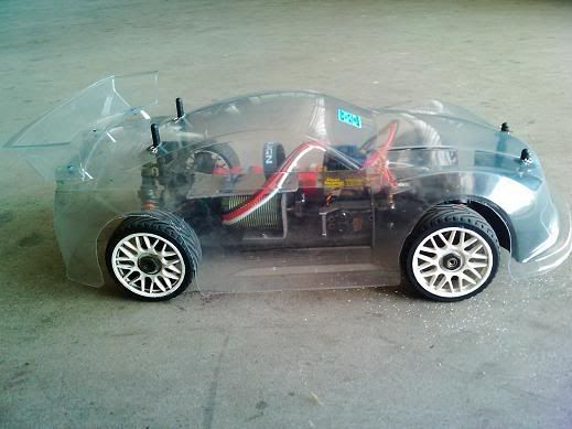

finfin 02.19.2009 05:31 AM

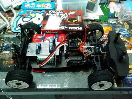

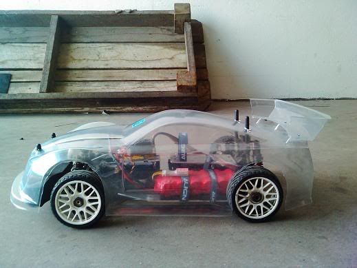

My MMM 2200 COMBO IN OFNA GTP
BATTERY PLATE
http://i201.photobucket.com/albums/a...553/plate1.jpg
http://i201.photobucket.com/albums/a...553/plate2.jpg
CUSTOM MOTOR MOUNT
http://i201.photobucket.com/albums/a...otorplate1.jpg
waiting for Mike's motor mount.... :yipi:

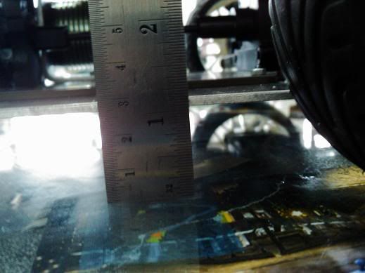

HEIGHT
http://i201.photobucket.com/albums/a...53/height1.jpg
FIXED ALL IN GTP
http://i201.photobucket.com/albums/a.../COMPLETE1.jpg
suicideneil 02.19.2009 07:31 PM
Looks sturdy, what's the plan for that setup?
Sammus 02.19.2009 07:54 PM
That motor mount looks like it could be a little too flexible, what's it made from?
What's_nitro? 02.19.2009 08:24 PM
Hey finfin! I have one of those! :mdr: Are you running 4s/5s/6s? I hope your tires are belted- whatever voltage you run!
It's 1/8" aluminum. If he doesn't hit any jumps with it, it should be OK. I would definitely support rear end of the motor though. He's waiting for the RC-M mount anyways....

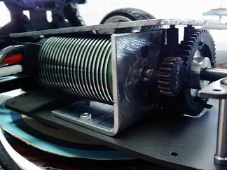

Hey guys just about have the GTP done.I fabricated a few simple custom pieces.Mikes battery trays are so easy to install.I have a Protoform PF8 GT 1/8 body for it.300.00 for the kit and RCM conversion parts.If it doesnt snow here tomorrow its gonna get some lite testing.It has a Neu 1512/1.5D/F run on 4s.
http://img18.imageshack.us/img18/4882/dsc05001gu8.jpg

B4maz 02.19.2009 09:23 PM

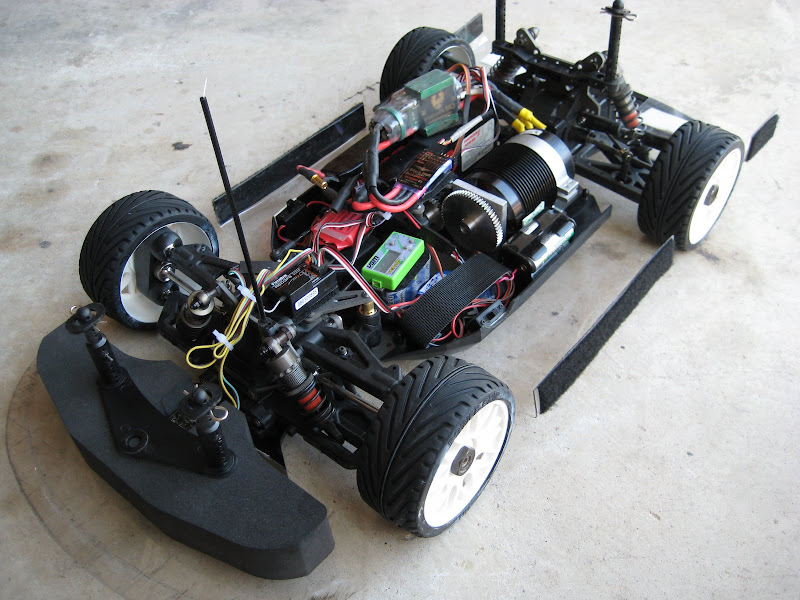

Heres my conversion:
Neu 2215/3Y
8s 3300mah
HV-110

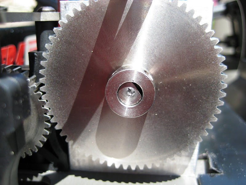

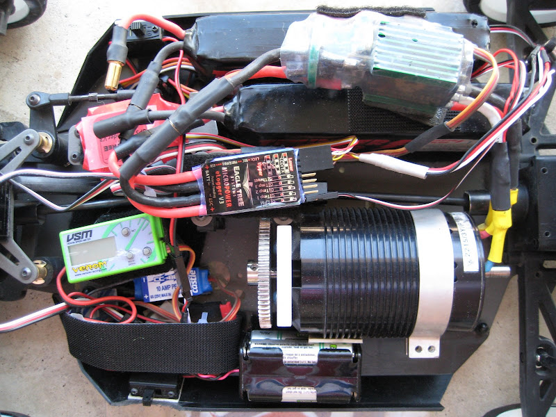

http://lh3.ggpht.com/_3N0hwXEVK9I/SF...0/IMG_0084.JPG
http://lh6.ggpht.com/_3N0hwXEVK9I/SF...0/IMG_0070.JPG
http://lh6.ggpht.com/_3N0hwXEVK9I/SF...0/IMG_0064.JPG
http://lh3.ggpht.com/_3N0hwXEVK9I/SF...0/IMG_0004.JPG

Wow, that sure is a large pinion!
Thanks suicideneil... just make topspeed....
put 6s 2p A123
:yipi:
finfin 02.20.2009 01:06 AM
Thanks... What's_nitro? aluminium thick 3mm
running in A123 6s2p

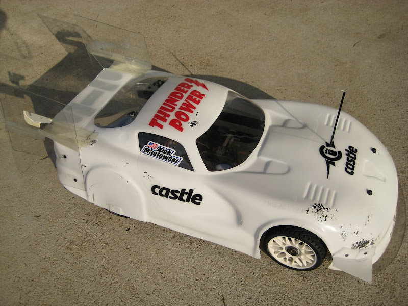

JUST ROUGH CUTTING BODY AND DRILL BODY HOLE...
http://i201.photobucket.com/albums/a...3/Bodyy111.jpg
http://i201.photobucket.com/albums/a...3/bodyy222.jpg
http://i201.photobucket.com/albums/a...3/bodyy333.jpg
NOT STICK STICKER AND COLORING YET...
What's_nitro? 02.20.2009 01:55 AM
Looks good so far. What are you gonna do for paint? 6s2p A123 is going to be awesome. It will have TONS of punch so watchout if you hit the throttle hard.
