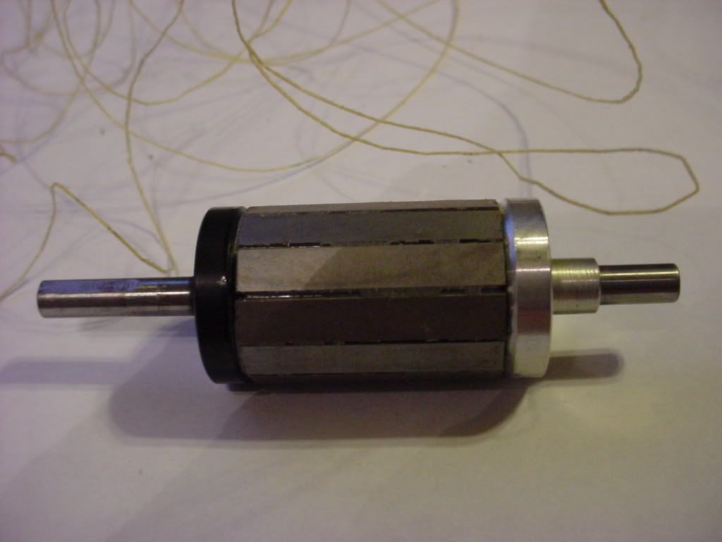

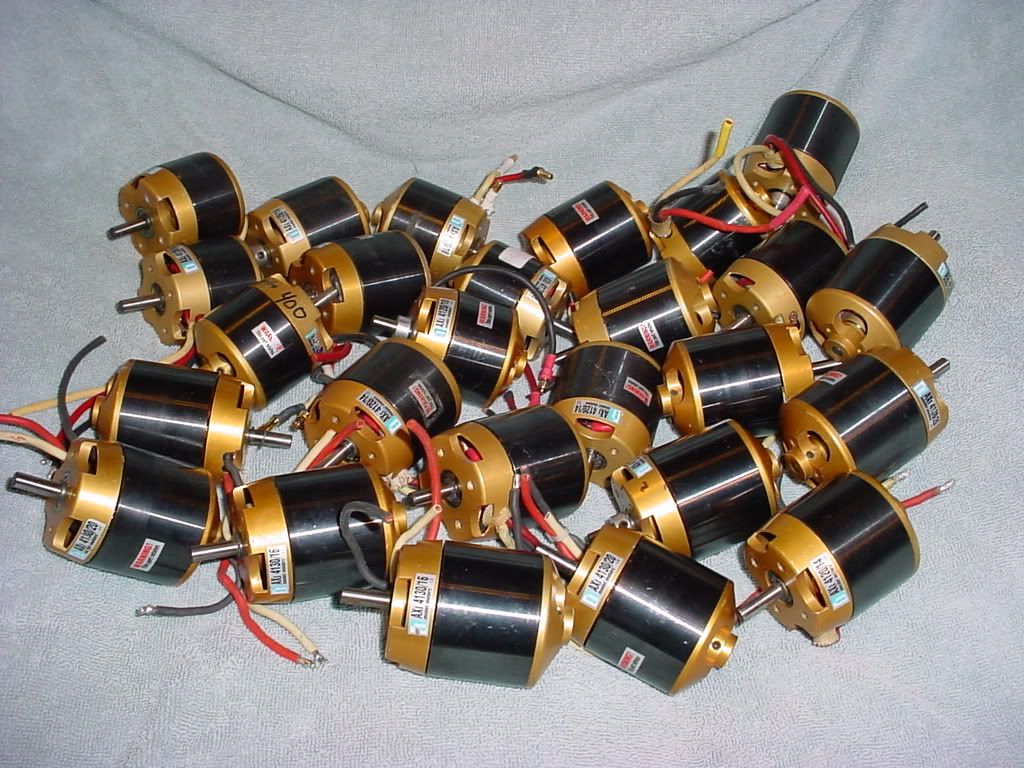

I do have several motors to rebuild. :lol: If anyone is interested in a AXI 4120 or AXI 4130 in just about any wind. I will have these rolling off really soon. Just pm me with your needs. http://i160.photobucket.com/albums/t...m/DSC07316.jpg Has anyone ever seen a Pletty Maxx Rotor with the kevlar removed? The Pletty Max is a 4 pole motor using 12 magnets that are 5mm wide, 30mm long and each is about 1.5mm thick. Pole configuration is NNN-SSS-NNN-SSS, making it a 4 pole motor. I'm thinking about replacing these magnets with some N50 magnets. Then replacing the Kevlar Wrap. http://i160.photobucket.com/albums/t...m/DSC07315.jpg |
you ship them axi motors to england?
I'll go back as a 4 pole since the winding I have is good. I wonder what strength the magnets are in a Pletty from the factory? I've read several places about demagnetized rotors. |
