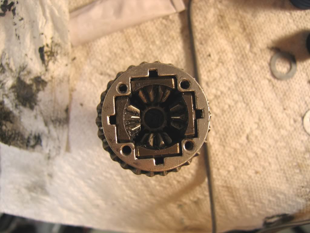

The Mod is fairly straight forward. The Cen diff is a std 1/8th size. The Savage output cups do need to replace the Cen output cups. The holes are centered properly, so the only real work need is to increase the thru hole for the drive pins from 2.5mm to 3.0mm.
I've seen others use a 1/8" (0.1250") drill bit to do this. I used a 3mm (0.1181") as I didn't want any slop. In the end I had to do a bit of filing to the hole to get the thru pin through easily, as well as the spider bevel gear to go on smoothly. In the end I would prolly just go w/ a 1/8" bit for simplicity. Also, the Savage output cups are not as hard as I expected, so a standard bit cut through it fine.
Be sure to take your time and get the hole as straight as possible. File any edges so the spider gear slides on easily.
http://i7.photobucket.com/albums/y25...f/IMG_6199.jpg
Reassemble the diff with the new Savage cups as well as a rubber shielded 8x16mm bearing. Don't use the unshielded bearing Cen uses. Fill w/ your favorite oils.
Note: Not pictured but later installed are Cen Cross Pins. These are optional and not required, but are one more bit for strength, as well as less oil needed to fill.)
http://i7.photobucket.com/albums/y25...f/IMG_6202.jpg

Not quite done! Remember that the Cen ring gear is smaller than the Savage's. Therefore the drive pinion will have to reach further in the diff case to mesh with the diff. You will need several 8mm shims to do this. I used a total of 2.3mm worth of shims to get the proper mesh. YMMV.
http://i7.photobucket.com/albums/y25...f/IMG_6213.jpg
Time to reinstall the drive pinion and diff, check mesh, then seal it up and go!
http://i7.photobucket.com/albums/y25...f/IMG_6206.jpg
