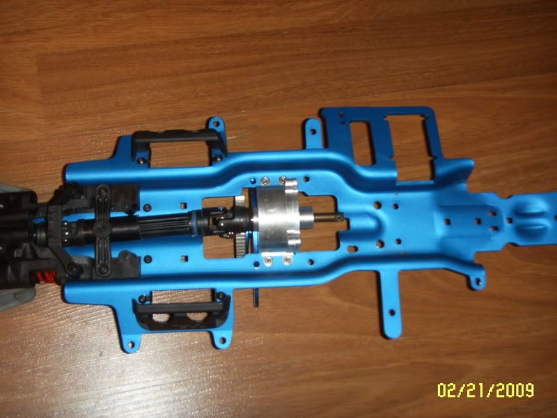

Urgeoner 03.08.2009 01:35 PM
this is all that I have so far, the transmission is just packed with automotive wheel bearing blue grease:
http://i10.photobucket.com/albums/a145/urgeone/revo.jpg
Also, is there a way to use steel center drive shafts with this transmission installed, instead of the bulky plastic ones?
Urgeoner 03.08.2009 06:38 PM
u guys think that this is the way to go? Or should I try a different route? like using the stock revo tranny and tekno conversion or rc monster motor mount? I heard some bad things about the electriclutch but I could just use a regular pinion instead.
Arct1k 03.08.2009 07:07 PM
No continue this setup works great - Just take most of the grease out of that trans - you only need a light coating...
suicideneil 03.08.2009 07:13 PM
The old emaxx tranny wont work with that centre diff, as its ment for the new emaxx/erevo, so that route isnt open to you.
You could modify the chassis to fit the new tranny & use the center diff if you wish, but your current tranny will be redundant.
If I were you, I'd probably use the tranny you have and live without a center diff- they are a bitch to tune properly anyway so you are better off without :mdr:
As for center drive shafts, you would require a custom length due to the emaxx tranny and revo chassis- best bet would be for custom steel dogbones from Mike, made to any length once you know whats needed.
