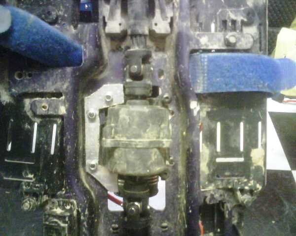

jzemaxx 03.17.2009 08:20 PM
3 Attachment(s)
You can see I run bolts through the frame and the bracket and sandwich the trans in. It won't move not one bit. Ran it at the track yesterday for over 2 hours. Absolutely ran away from a E-revo that was with me at the track with the same basic setup. Its just much lighter on its feet and handles alot better. Also because its a lightweight setup I was able to gear it quite aggressively on lower voltage. Motor, controller and batteries have yet to go over 120. That was over an hour of laps...non-stop, just swap batteries and go. Running 10,000 mah so runtimes are LONG.
magman 03.17.2009 08:23 PM
Did you do any mods to your trans?
jzemaxx 03.17.2009 08:26 PM
nope....the 3905 tranny is brushless ready. So far its bulletproof. Ran it on 5S last night for giggles....57mph on the GPS.
magman 03.17.2009 08:42 PM
Would it handle 6s...because that is what I will be using
jzemaxx 03.17.2009 08:54 PM
No problem....
