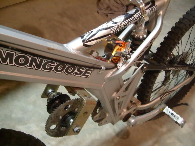

I am working on my e-bike project. I picked up a 100a suppo esc from hobbycity along with a 250kv outrunner. It is wayyyy overgeared. Could somebody rewind it to a lower kv? About how much would this cost?
I don't know what kv I need either. I'll need to calculate the gearing. What does it take to figure out how chains and sprockets effect gearing? Is it just like a spur/pinion?
and since pics always help -
http://i345.photobucket.com/albums/p...1/S7301761.jpg
http://i345.photobucket.com/albums/p...1/S7301763.jpg
edit - tell me if the pics don't work. Might have messed them up.

http://i345.photobucket.com/albums/p...1/S7301705.jpg
I can't get too much smaller...

I see now you are using a stoker setup. Can you run the chain from your stoke hub to the biggest ring on your cranks?
sabongi 04.05.2009 10:06 PM
Have you tried using a big spur on the upper right side of the bike?
Metallover 04.05.2009 10:25 PM
I could do that but I'd have to get a couple chain links and the pedals would spin really fast. I might do that if rewinding it proves impractical for the cost.
sabongi - That part is a freewheel and acts as a pinion. Making it bigger would make the gearing even worse.
The gear reductions are - 11/72 to the "spool", 14/32 to the crank, and 48/12 to the wheel in top gear. I want to get about 35 in top gear. The motor is 250kv at the moment and I'm running 24v. That's 6000rpm. The wheel has a 13" radius so 2pi13=81.7 inches/revolution.
I'm not quite sure on my math, but I think I get 1,584 rpm at the wheel so that's... holy sh!t - 180mph!!:lol: - Someone check my math...
I figure I will need 1,168rpm at the motor so thats... 49kv.:oops:
Is this going to work out or will I need to make some major changes to the gearing?:neutral:

I think another 5/1 gear reduction will do the trick. Ill see if I can figure out a way to do that tomorrow.

it's been a while since i was in school, but i thought it was pi X diameter, not 2pi X diameter. if you do single diameter you get 40.82. Still moot point because if everything else is right, you are still looking at 90 mph and still need further reduction or lower kv

metallover's right... It's 2*pi*r to get circumference or a circle

It is a heavy bike... Its really heavy with the new stuff too! I think it was 35 before the stuff and now it's probably 65+ pounds.:surprised:
To all those who checked my math, it seems I did it right? I sure hope I did. I'll figure out a good way to do the rest of the reduction at school today. Nothin better to do....:neutral:
johnrobholmes 04.06.2009 08:09 AM
Another 5:1 would be your best bet. Can you pedal at 35mph though? search google for top hat adapter, you could put a 36t sprocket on your disc brake side and get all the geardown you need with your stoker setup.
Just going down in KV won't help, you will loose all of your power.
