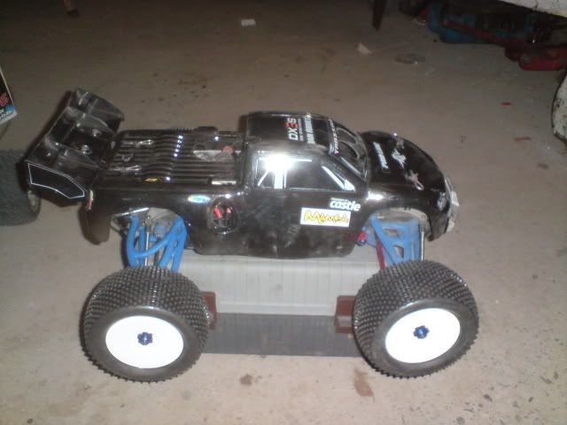

well after all my babaling..here is what i actually race!
http://i102.photobucket.com/albums/m...n/DSC00021.jpg
http://i102.photobucket.com/albums/m...n/DSC00022.jpg
http://i102.photobucket.com/albums/m...n/DSC00023.jpg
specs:
MMM + 2200 combo (wish i had a medusa 2000kv 70mm instead! motor can diameter is smaller and i could gear lower and bump up the voltage = cooler running)
zippy H 5s and 4s lipo's (2x5s and 1x4s)
E-revo diffs
3905 tranny
thunder tiger ACE DS1015 servo
techno sway bars
geared 16/68
center diff (yes it helps in this case..not a waste of time)
crime fighter M2 MTR's (prolly get some bow ties for the wetter months)
traxxas wing mount casue the techno mount sucks balls
trx wing....just casue lol
RPM true track and front arms and knuckles
DX3s radio...AND A HORN!!!! (not pictured...has to be mounted up again)
and the rest isnt worth worrying about :wink:
race this week end :yipi::yipi::yipi::yipi::yipi:
just have to beat a mambafyed RC8T and a mambafyed MBX5B:neutral:
that's next to impossible....lol
shaun

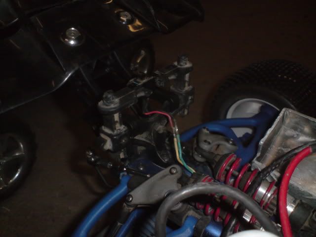

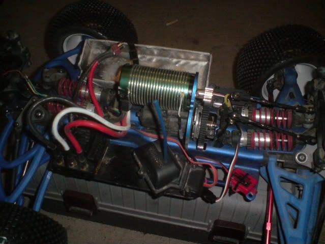

mopar1994 04.30.2009 08:21 PM
thats so cool where you mounted the on off switch. never thought of that before and cool revo
4xFord 05.01.2009 02:07 AM
Thats funny that is exactly where I have mine mounted. So you have your trans mounting tabs underneath the chassis? Does the stock skid stil clear?
shaunjohnson 05.01.2009 06:30 AM
no bottom skid plate...if i could be bothered buggerizing around i could get this titanium one to fit but i cant be arsed:lol:
no tranny mounting tabs...just dremeling in just the right places and washers on one screw because it's offset a bit (yes a little yuckey but works well)
the only weak point left is the center driveshafts...but have steel E-maxx one to mod soon so that will go into it asap.
shaun
