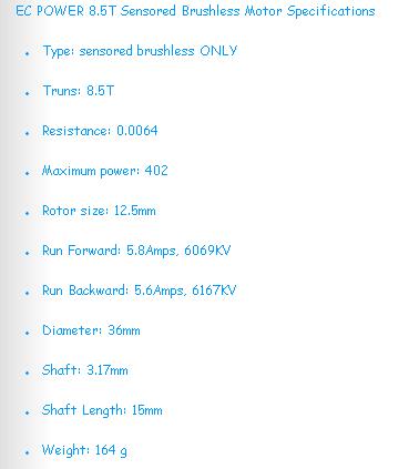

Is it possible to have a 8.5T 540S motor with a KV rating of over 6000?
1 Attachment(s)
I got the specs from a vendor.
It is a 36 x 50mm motor by the way.

Hey Thanks for all your replies.
Most of the 8.5T 540S motors out there have around 4000KV. I thought the vendor made a mistake or something.
And oh i did notice that the ecpower motor has a rotor diameter of 12.5mm. Somehow I feel that this motor has very a low torque as compared to other similar sized/kv motor with fewer turns.

http://www.ecpower.com.hk/index.php?...roducts_id=267
Seems like the vendor made a mistake. I found the ecspeed 8.5T motor listed on ecpower's website as a 4000 KV motor.
