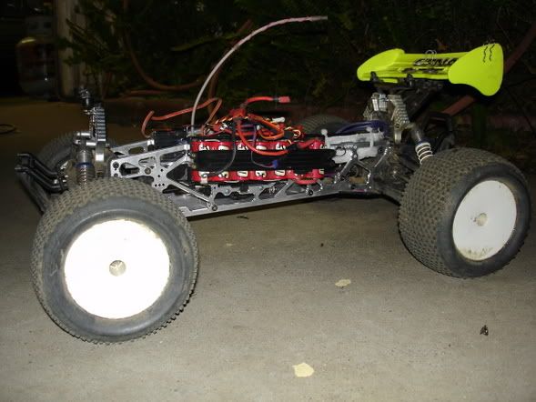

Finished up most of the build this morning, I just have to clean up the servo wires and stuff tomorrow. I think I will also pull most of the screws out and loctite them, but we'll see. The guys at Hobby People were pretty impressed with it, as am I, and I'm surprised that it still has quite good center ground clearence.
What's that peeking outta the shadows?
http://i8.photobucket.com/albums/a5/4718/DSC03341.jpg
Ha ha, take that nitro dorks!
http://i8.photobucket.com/albums/a5/4718/DSC03344.jpg
stampy 01.24.2006 03:49 AM
looks disgusting :D whats the wb on that bad boy?
coolhandcountry 01.24.2006 10:06 AM
looks like you need more batteries now. The packs looks small on the side of it.
nbcaznmaster 01.24.2006 02:26 PM
ya. Wuts the poitn of a logner chassis uf i dont put more cells? Looks really nice. looks like a LSP for a sec..
boss 302 01.24.2006 04:37 PM
looks nice but i also think it needs more cells
coolhandcountry 01.24.2006 04:47 PM
What kind of body you going to run now? It looks about long enought for a mgt body or something.
dabid 01.24.2006 10:07 PM
Yeah, I think it needs more cells too, was planning on putting a 9xl in and running at least 18 cells......the 7 cells on each side right now just looks too small. As for the body, don't know yet, the wheelbase is somewhere around 14.5" (haven't measured it to be sure) which is about as long as the Hot Bodies Lightning ST and other race truggies, so that opens up some cool options. According to Tower, the MGT's wheelbase is about 14.5", so the bodies for that one would work as well. The old F-350 body I had won't work though, it'd look retarded because of how short it is anyway.
coolhandcountry 01.24.2006 10:19 PM
I think my double extende maxx is about that. I havea mgt body on it now. It looks better than the others i had.
dabid 01.24.2006 11:14 PM
I set my Twin Force's Suburban body on it just to see how it'd fit, it was way too short, by at least 2" on each end!
dabid 01.26.2006 02:58 AM
Well, I finally ran it tonight, pretty crazy! The 9L was overgeared at 16/49 (I think that's what the pinion was), so I bumped it to the 52 tooth spur and it ran great. It bombed up and down a dirt hill next to my house with ease, even flew across the grassy area at the top real quick too. System stayed stone cold during the short 3 minute run until the pinion set screw backed out.
Oh yeah, the wheelbase is between 14.5" and 14.75".....had trouble reading the little marks and keeping the front lined up with the middle of the wheel nut. My only problem with the body choices is that no matter what I get, it'll ride kinda high on the low slung chassis. Just so long as there isn't daylight visible though, that's one of my major annoyances.
