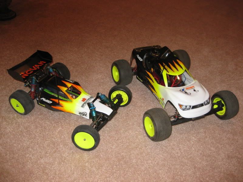

You can buy createx from hobby lobby, and a cheap $10 airbrush from harbor freight. The createx works well, and you can paint several bodies with it using the airbrush. Its about $4 a bottle. I just did these and maybe used 1/4 of a bottle of each color.
http://img.photobucket.com/albums/v6...s/IMG_0735.jpg

Junkman's shells are clearly 100% airbrushed, just used some masking tape/fluid to get the shape.
