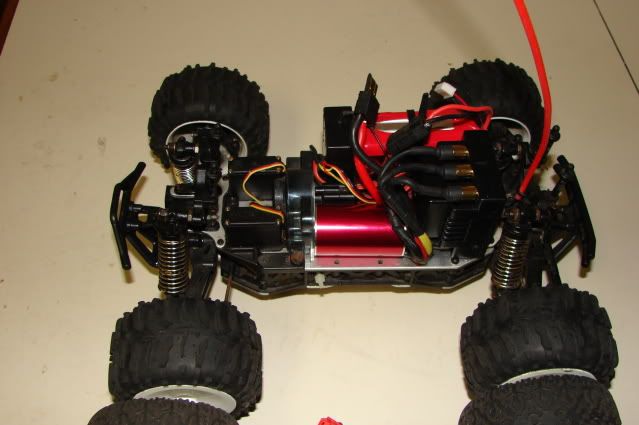

how about in a 1/18?
http://img.photobucket.com/albums/v2...s/DSC03774.jpg
mikey84's monster powered mini lst
dkexige 07.04.2009 05:03 PM
Haha! Thats great! Excellent job Mikey!
