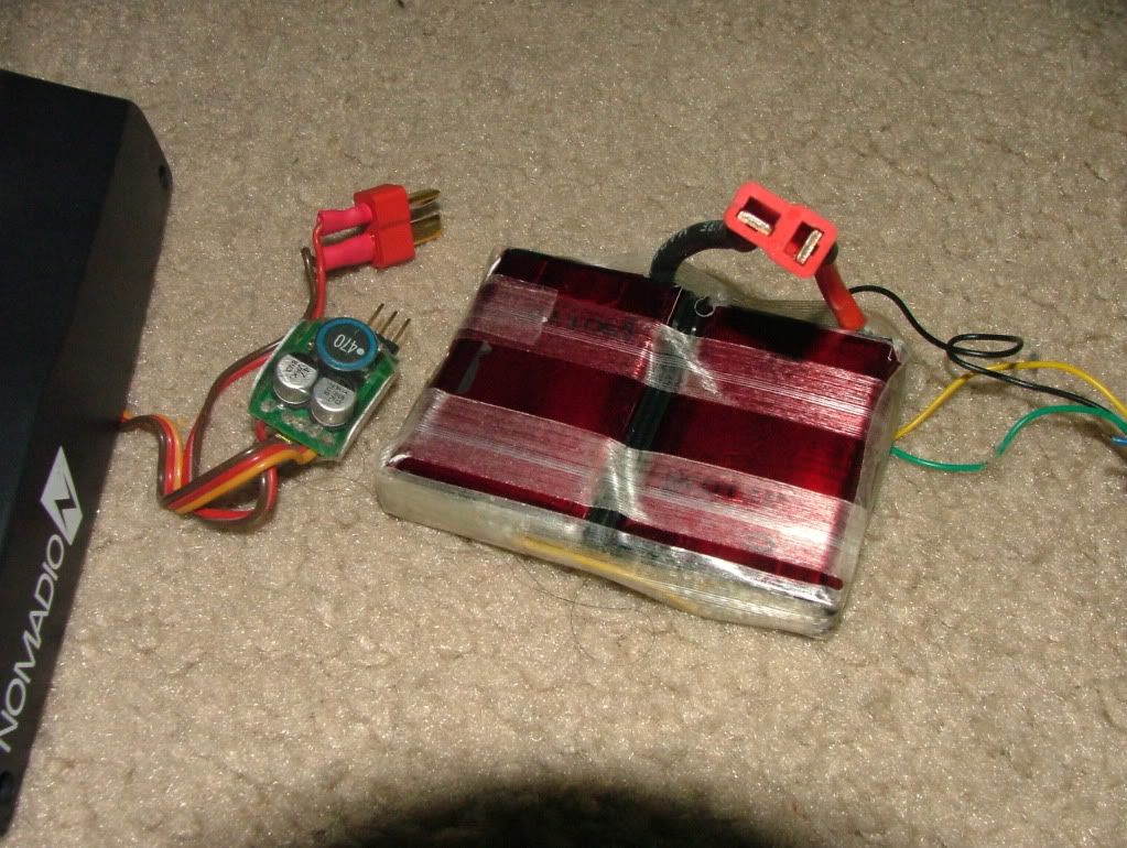

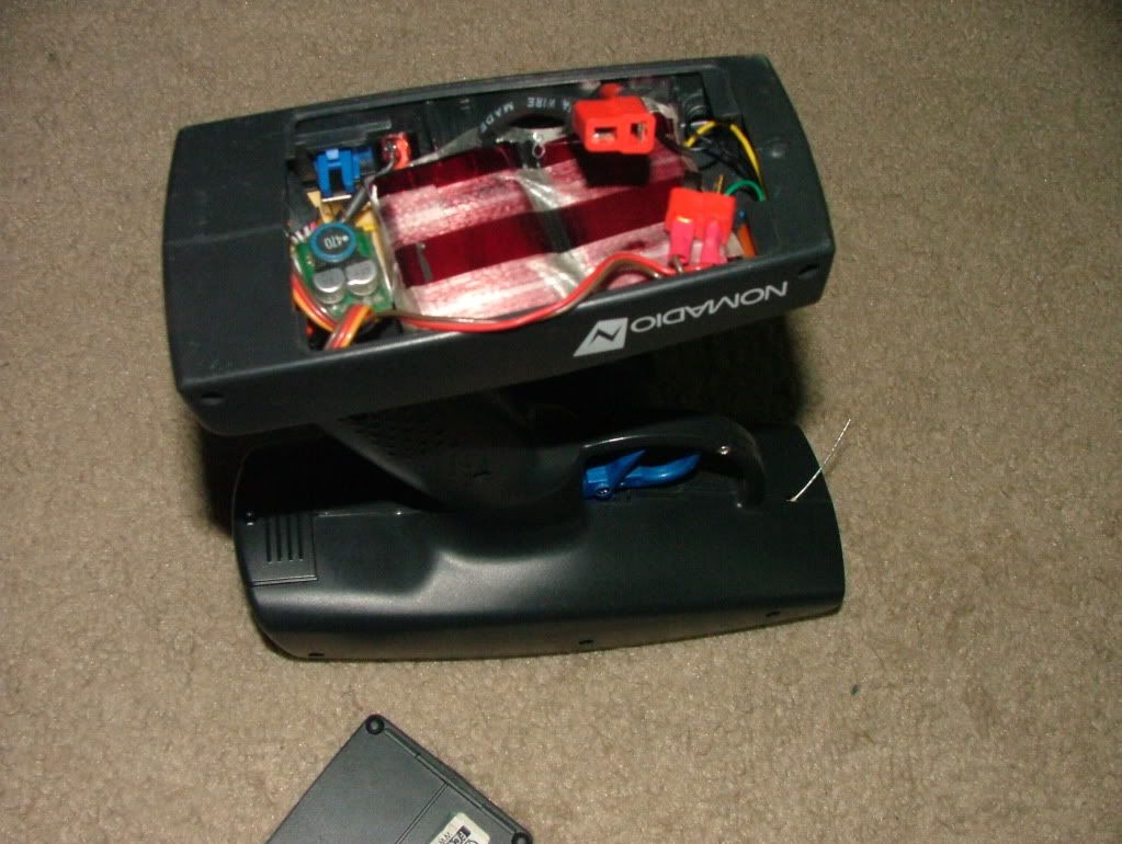

snellemin 07.05.2009 10:58 PM
I use little flat lithium ions in my nomadio. I haven't bothered with the airtronics yet. I use a dimension engineering bec to drop it to 5V. Don't feel like burning up my nomadio.
http://i189.photobucket.com/albums/z...o/DSCF6438.jpg
http://i189.photobucket.com/albums/z...o/DSCF6440.jpg
