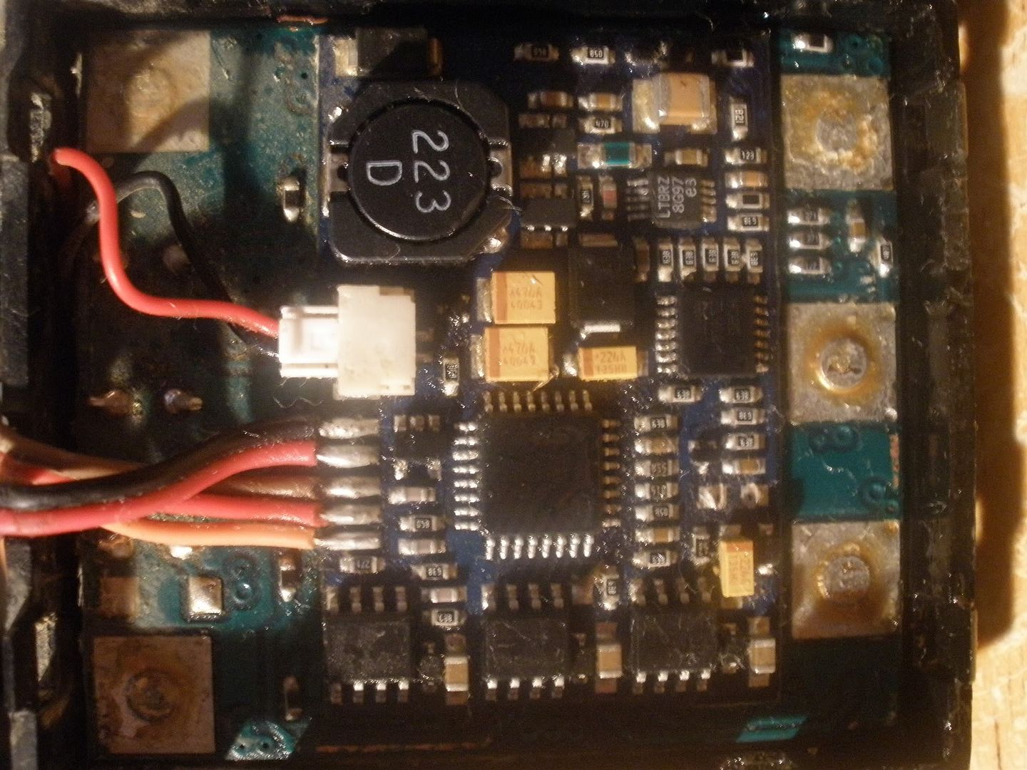

Can you distinguish the similarities and differences between these two pictures?
http://i152.photobucket.com/albums/s...0/P7190025.jpg
and this one
http://i152.photobucket.com/albums/s...0/P7190024.jpg
It turns out, the difference is that one is my MMM, and the other is Ben's (brushlessboy16).

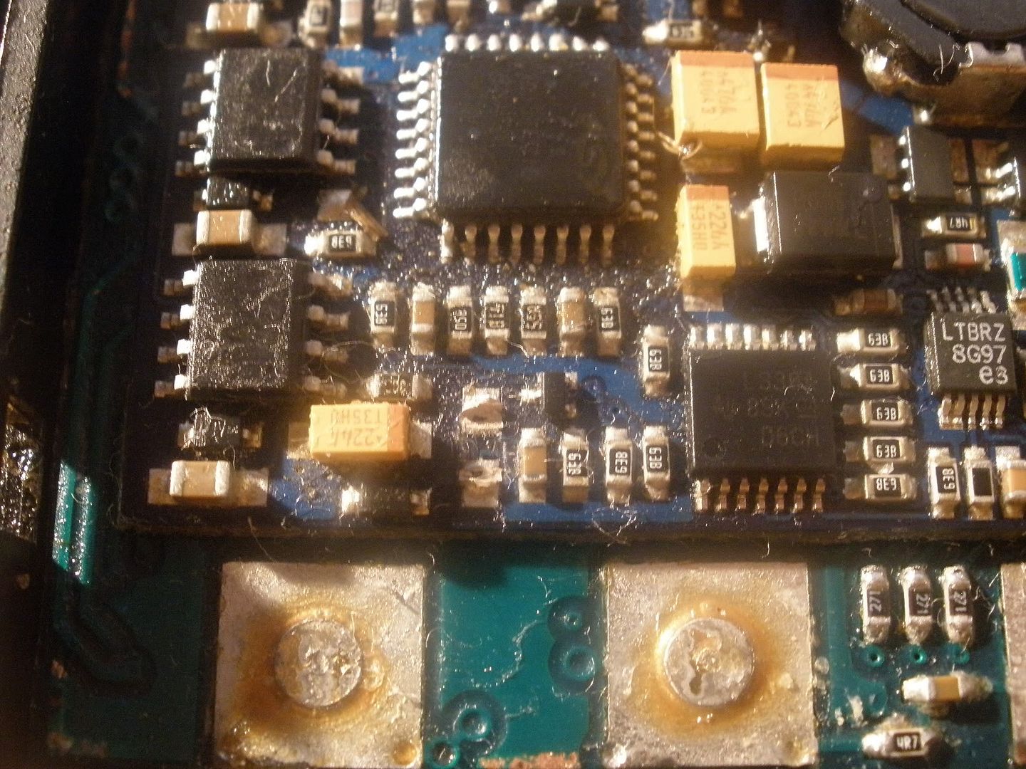

The similarities are that they both died on the same day, in the same exact way, with the same exact symptoms. Come to find out, the same exact component failed on each one! See the lower right corner, just to the left of the bottom bullet terminal. there is where there was once a component of some sort, but now is gone, from both MMMs, within 4 hours of each other, within 50 feet of each other.
The symptoms are as following: lost throttle during a race, and went to check it out. no LEDs on the MMM, but BEC still works. We both had servo and Rx power. Castle link does not see the MMM either.
My system is:
Hyper 7 conversion
4s NeuEnergy 5000mah 25c
14/46 gearing
standard diffs
Ben's is:
Revo 3.3 conversion
4s RC monster 5200mah 27c
17/38 gearing
Lst differentials
Proline VTR calibers.
Needless to say we are quite dissapointed with what happened, and hope it will be covered by castle when we call monday. here are some more pics:
http://i152.photobucket.com/albums/s...0719091830.jpg
http://i152.photobucket.com/albums/s...0719091832.jpg
http://i152.photobucket.com/albums/s...0/P7190027.jpg
http://i152.photobucket.com/albums/s...0/P7190028.jpg

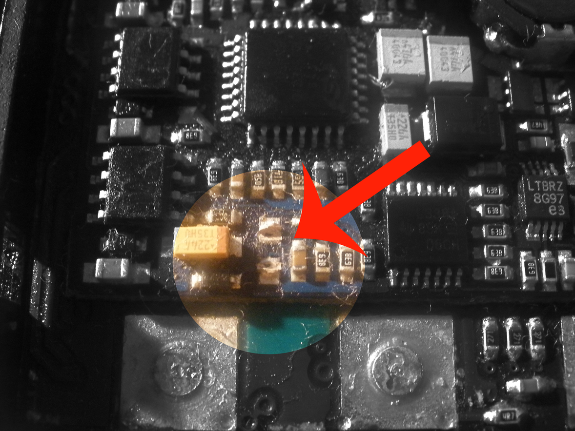

here is a highlighted shot for better clarification
http://i152.photobucket.com/albums/s...010/hilite.png

I'm guessing its the TVS... bad luck

I know we tried some of that new no lead solder with one of our kit assemblers for the purpose of trying ROHS compliance and we had several components fall off of boards just like this.(we supply another company with our components and boards and they assemble them), We said screw it and switched back. Just about all the components you get these days are ROHS compliant (Removal Of Hazardous Substances). When we first started getting them in we had problems like this even assembling them at our shop. We also use water soluble flux (in house) which flows different than regular rosin flux. Some times it just seems the solder doesn't want to bond with the tinning on the component. We started a vibration test on the boards now to try and avoid this. We finally solved it, but I wonder if that could be going on here.

TVS = Transient Voltage Suppressor (I think. It prevents harmful voltage spikes from damaging the caps) . I believe its actually located under the wires between the main + and - attachment points for the battery wires. Im sure a Castle dude will chime in sooner or later and identify the missing component- and then a solution/ redesign will be sought (MMM V4? you never know....).
brushlessboy16 07.20.2009 12:27 PM
Just got off the phone with Thomas, as I directed him to this thread. it is a tvs. it will be replaced/repaired under warranty..
Since mine is missing a solder pad it will be replaced, mikes is repairable...
3 week lead time..
