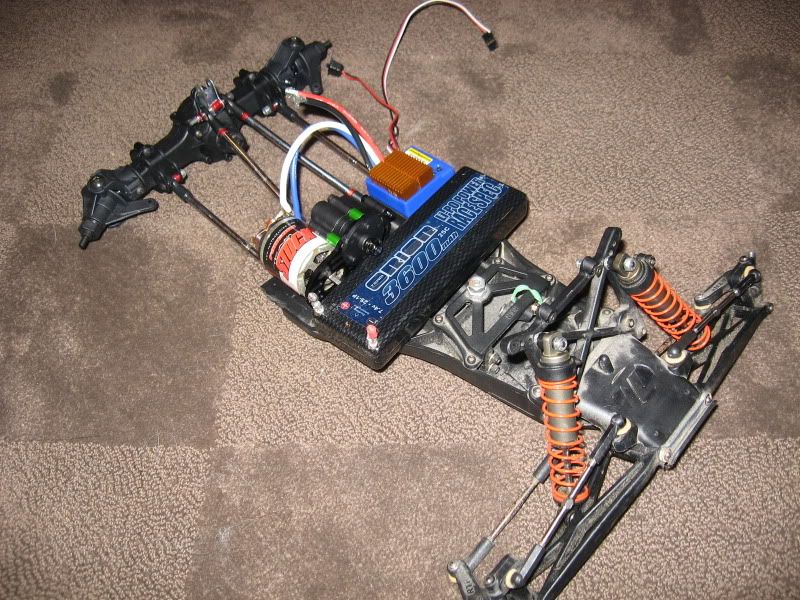

mopar1994 08.23.2009 12:13 PM
i got the ax-10 trans yesterday.heres a pic of how its all gona be layed out. that is not the esc or motor i will be using. and there will be bracing where the upper links are. maybe i could use wheels from the losi strike or the losi desert truck?
http://i655.photobucket.com/albums/u...1994/22015.jpg

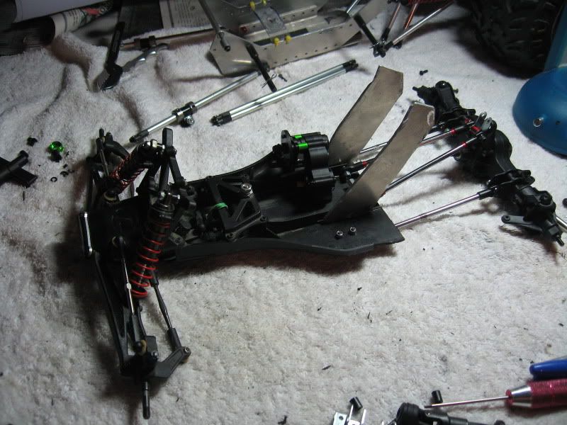

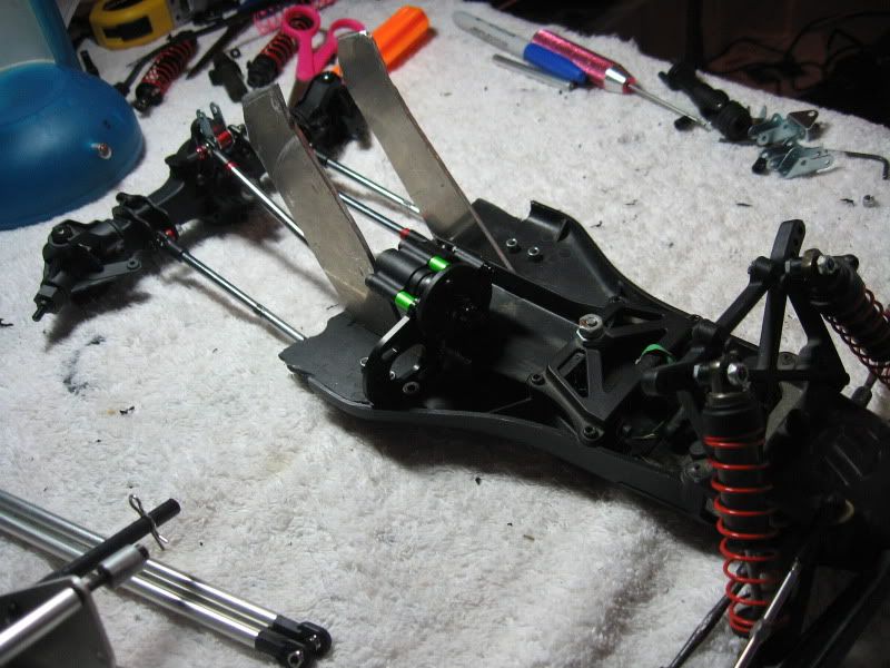

mopar1994 08.25.2009 11:48 PM
heres a pic of what the shocks will be mounted to
http://i655.photobucket.com/albums/u...1994/25008.jpg
http://i655.photobucket.com/albums/u...1994/25010.jpg
