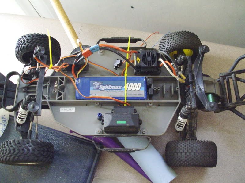

they are one millimeter wider then the 4000packs, the 3s 4k pack is a snug fit in my slash.. it just might be possible... might need some light dremel sanding though.
http://i152.photobucket.com/albums/s...h/PICT0009.jpg
You will need a notch for the wires to come out through.

Dang that doesn't look safe. Wheres the shrink on the motor wires?:lol:
Don't run it until you dremel the notch in the side. It'll pinch the wires and most likely destroy the battery(check the biggest blunders thread for the full story:diablo:).

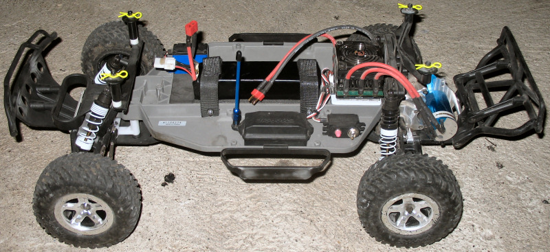

I didn't want to chance compromising the structural integrity of the chassis by dremeling the sides, so I just mounted the battery on edge and added a little bit of rubber-foam weatherstripping padding on the sides:
http://scriptasylum.com/bl_conversio...es/slash_3.jpg

clear heatshrink from radio shack. works just the same :yes:
