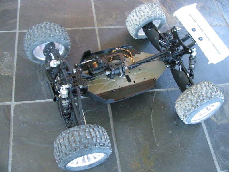

fallguy 08.30.2009 05:49 PM
One more MBX6-T
Installing a MMM combo.. have had good luck with it in my Revo. just waiting for my RCM motor mount and a set of rims (the rims and tires are for my Revo)
Thinking of running a 1/16 revo reciver box its nice and small.. http://cgi.ebay.com/Traxxas-1-16-E-R...d=p3286.c0.m14
and other than that I need a way to hold down my lipos.
http://i44.photobucket.com/albums/f4...thersss010.jpg
http://i44.photobucket.com/albums/f4...thersss011.jpg

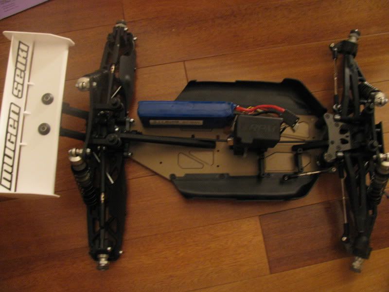

fallguy 09.06.2009 01:06 AM

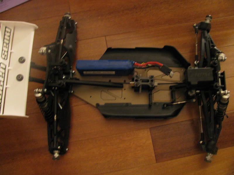

well all of my parts should be n next week.. .im thinking of standing the lipos up on end like in the photo on pack on each side.. motor facing forward and the ESC on top of the center diff or some how on top of the steering survo.. dont want to flip on its side.. but i could.
I got a RPM RX box its pretty small but not super short.. it will work fine in these two areas.
http://i44.photobucket.com/albums/f4...thersss013.jpg
or
http://i44.photobucket.com/albums/f4...thersss014.jpg

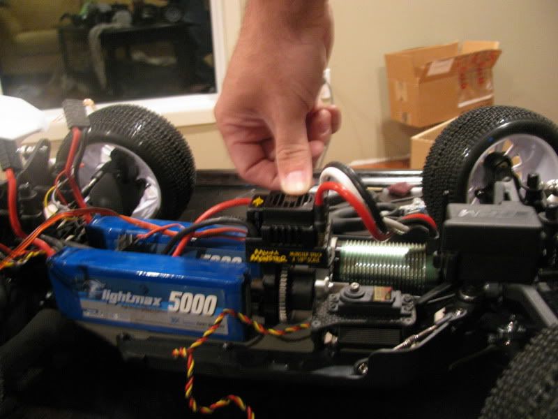

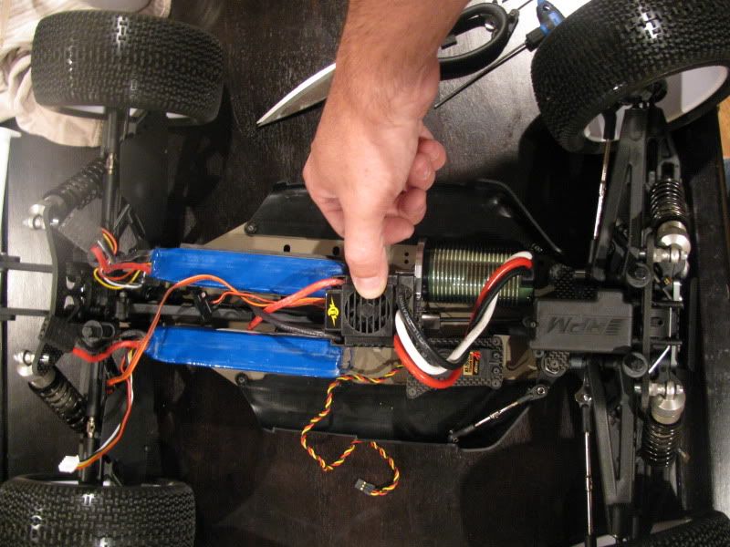

fallguy 09.09.2009 01:03 AM
Well got my wheels, tires, motor mount and MMM 2200KV combo in the mail today. funny thing it was 3 different companies shipping to me and they all turned up with in 1 hour of each other.

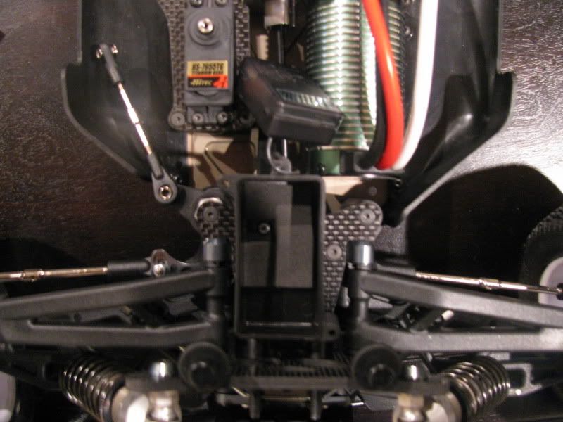

Just drilled one hole in the RPM rx box and used the chassis brace upper bolt hole.. added some foam so the screw was not tapping the bottom of the RX all the time.
http://i44.photobucket.com/albums/f4...thersss017.jpg
thinking about getting a laser cut plate up top to mount the ESC.. dont know how much I like this spot.. it was that or flip the servo on its side and mount it on top there.. more of a pain.
http://i44.photobucket.com/albums/f4...thersss018.jpg
http://i44.photobucket.com/albums/f4...thersss019.jpg
Jconcept wheels with AKA city blocks.
http://i44.photobucket.com/albums/f4...thersss022.jpg
now i dont know if im going to flip the center diff and mill a slot in the bottom plate for the rear.. or run the tekno long pinion..

tedo 09.09.2009 12:32 PM
Use the long shank pinion. That's what I did. Fits perfect. Make sure you reverse your motor direction too.
fallguy 09.09.2009 04:10 PM
Just picked one up the LHS had them in stock.. I was kinda shocked, did not think they would be a popular item.
magman 09.09.2009 09:22 PM
"thinking about getting a laser cut plate up top to mount the ESC.. dont know how much I like this spot..."
I have ALL of my esc on top of the center diff. I actually prefer it there as apposed to mounted on the chassis
