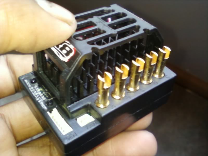

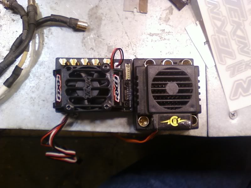

-As I open up my wonderful package from the folks down at rc-monster, the first thing I notice is How compact the esc is. its like a Mamba monster that got a tummy tuck.
-tolerances on the case around the miscelaneous plugs, posts, and buttons is very good- not alot of gaps or anything of that nature

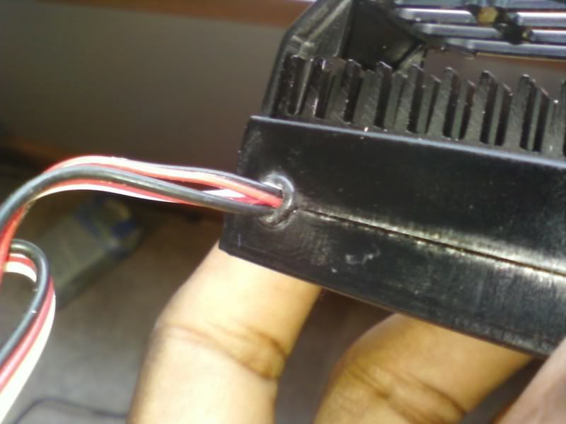

-I really liked seeing the grommet on the wires leading out of the esc, nice feature to prevent chaffing.
- The next thing I noticed wat that (at least to me) the rx8 was noticeably lighter. good for a small car or just a light setup.
Setup and arming
- Wire denotations (+,-) for battery and (A,B,C) are marked on the case of the controller at the base of the post. very simple to figure out. My only qualm is that the Solder posts need to have a larger crevice- 10ga wire barely fit- and seems to be becoming the standard among 8th scale vehicles.

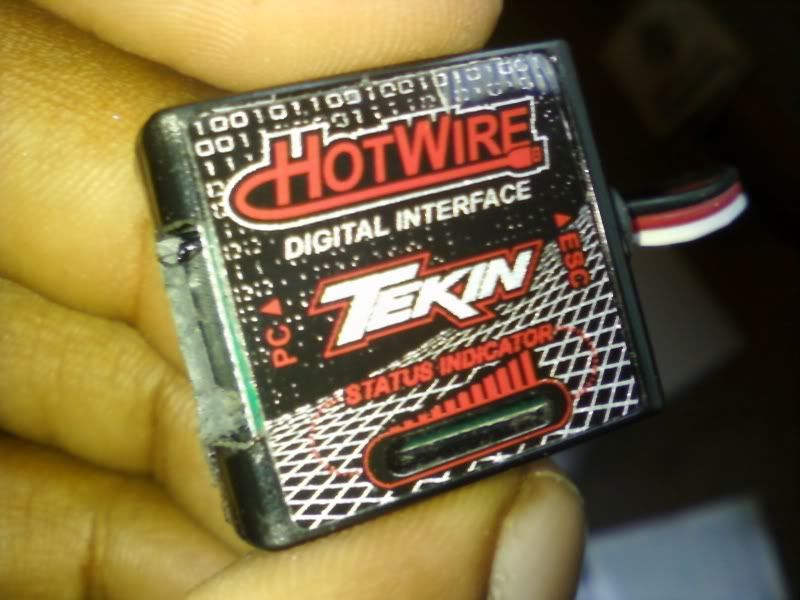

Tekin Hotwire
What to say about the tekin hotwire... besides that YOU DONT NEED IT! 90% of all the settings are tunable from the esc. The only thing you gain with the usb dongle is the ability to make custom throttle curves, custom voltage cutoffs, and things of that nature. The UI (user interface) is a bit overdone... To the point of confusion- Tone it down a bit and maybe lower the price... 30 dollars is steep.
And now for the pictures.
http://i152.photobucket.com/albums/s...911091447a.jpg
http://i152.photobucket.com/albums/s...0911091449.jpg
http://i152.photobucket.com/albums/s...0911091450.jpg
http://i152.photobucket.com/albums/s...0911091542.jpg
http://i152.photobucket.com/albums/s...0911091457.jpg
