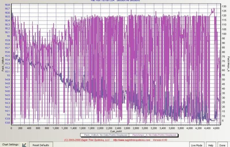

HPI is not lying when they say you need batteries that are capable of handling 120A continuous.
This was my first run. It was all off road. You can see I started off the run rather slow to get the feel for the truck. After a few minutes I got used to WOT and used it quite often.. :surprised:
The BLUE Line is Voltage and the PURPLE line is Amps
This is the entire run.
http://i20.photobucket.com/albums/b2...inex/Flux1.jpg

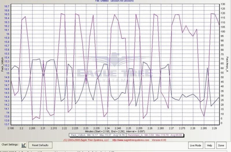

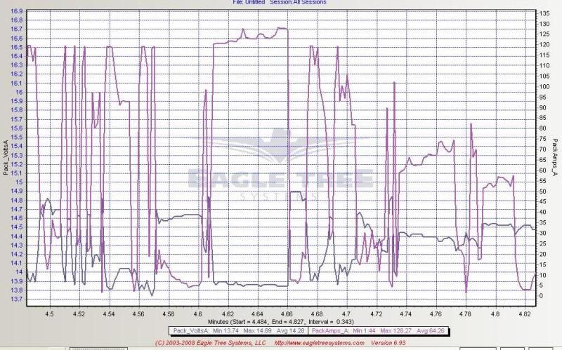

The next 2 graphs are zoomed in and show a few seconds of the run in detail. My voltage drops are about 1V under a 120A load.
http://i20.photobucket.com/albums/b2...inex/Flux2.jpg
http://i20.photobucket.com/albums/b2...inex/Flux3.jpg
My run was stopped short from loosing a wheel. The logger said I used 4600, I recharged about 4300.

Looks like you were running 4S batt's. What is your brake and drag brake setting? Your braking/off throttle amp peaks are higher than what I would have guessed - but I have only a browsing experience with the logger data...
fastbaja5b 10.28.2009 09:50 PM
Amp spikes look consistant with when I did the same sort of graphing on 4s Lipo on the Flux
TLTRyan 10.29.2009 06:27 PM
Drag brakes are off. Brakes are at 50%.
