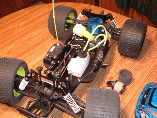

hey everyone new to this forum.
i just picked up a mammoth st for dirt cheap. would it be a bad idea to convert the truck to brushless? Is there motor mounts for this conversion? or get some made?? i looked around and only found a few home made mounts
what ezrun set up should i go with?
thank for the help.

It's NEVER a bad idea to convert a nitro smoker over to brushless!!! If Mike doesn't have something that will work he can probably make something.
Are you already set on EZ-Run? What about going with a true and tested Mamba Monster or Tekin? If you need to be cheap there is a new 150A HobbyCity ESC out that looks like it could hold it's own against the EZ-Run stuff.
