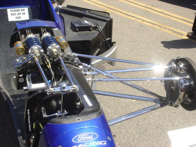

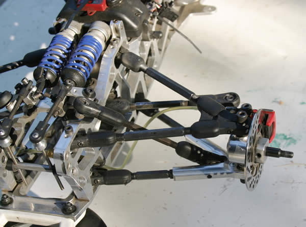

I have a custom build 1/5 that I want to switch to horizontal shocks using rockers like the revo. I think I need Progressive and not the long travel for my on road .
Is there an expert on ROCKERS ?
WHat Rocker options are there and for what use ?
Obviously long rockers are for long travel suspension
thank you
last PIC is mine
