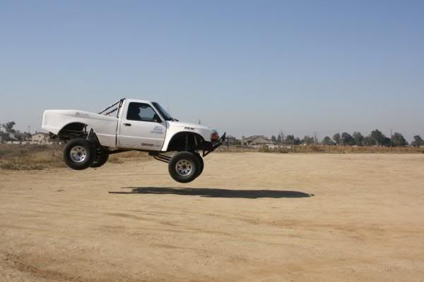

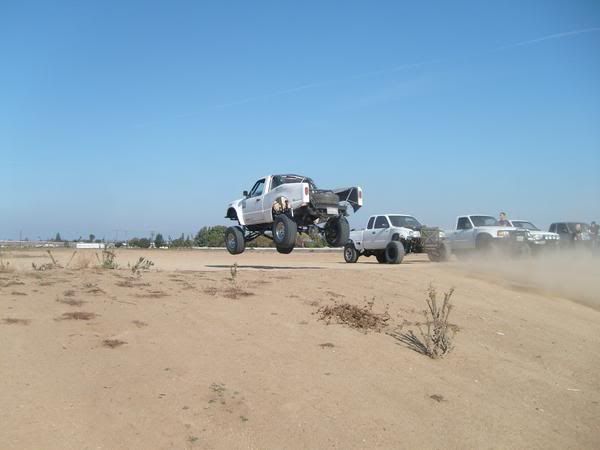

No dumb questions! Here are some pics of the truck I've studied the most for the build. It's not the same body style but suspension and layout is what I'm after. The only main difference is he's running leafs for back suspension and I'll be going 4-link.
http://i736.photobucket.com/albums/x...ch/Ranger1.jpg
http://i736.photobucket.com/albums/x...ch/Ranger2.jpg
http://i736.photobucket.com/albums/x...ch/Ranger3.jpg
