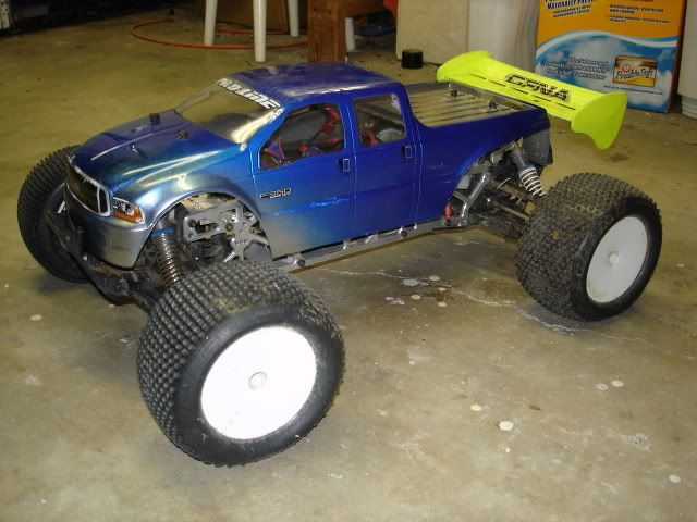

Hey, guess what? It's back, and it's got a body! I finally got around to painting the extended F-350 a simple scheme of True Blue Pearl backed with Indy Silver, came out pretty good, but it'll just get beaten to death anyway.
Onto the pics!
http://i8.photobucket.com/albums/a5/4718/DSC03714.jpg
http://i8.photobucket.com/albums/a5/4718/DSC03717.jpg
I hacked the rear of the body to give clearence for both the rear tires and shocks and stuff, as well as the wing mount. With it all pretty though, of course I had to take it out against my brother's crazy Pro 4 buggy, and had a bunch of fun.......and a massive crash.

boss 302 03.15.2006 11:44 AM
it looks good dabid
coolhandcountry 03.15.2006 12:02 PM
Looks pretty good. I wish you had got pics before the scratches and stuff.

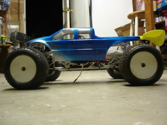

Because I killed the Ofna 9.5 wing mounts, I got some Xterminator ones on employee discount for $5 and bolted them up. I flipped the 1/8" alum. plate that the wing mount's screwed to so that now the wing is about 2" above the tailgate of the body, much better and I think it even gives it better performance. I work Friday, so I'll get a Proline white wing to replace the beat up Ofna yellow one, it'll work and match better.
I took it out for a run on some grass and was surprised as always by the power of "just" a 9L on 14 cells, but at the same time want more runtime.......I think what I really want is the 9xl though.
maxxdude1234 03.16.2006 12:30 PM
Thats one long savvy dabid. Looks awsome!
dabid 03.16.2006 04:02 PM
Yeah, it's weird to see a stock Savage now, mine is so different that they just don't look right!

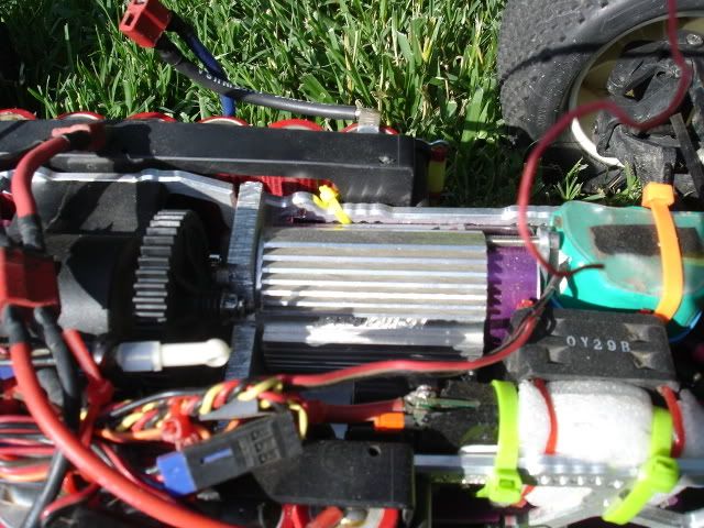

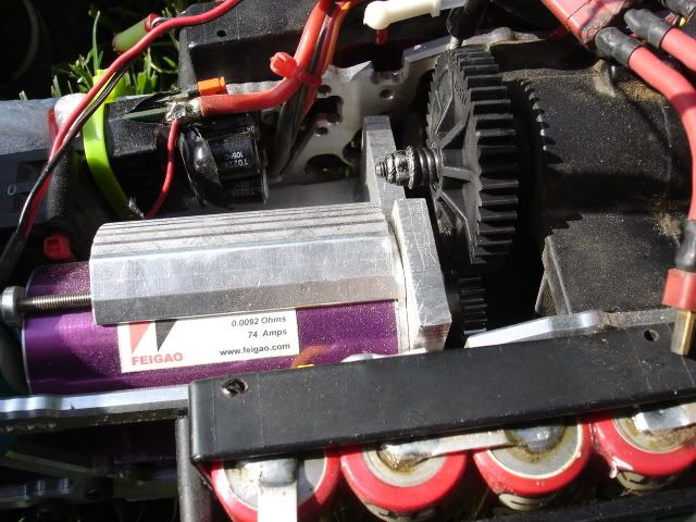

Rcbros 06.02.2006 11:51 AM
How is your motor mounted? Got a picture with the body off?
dabid 06.05.2006 02:14 AM
http://i8.photobucket.com/albums/a5/...e/DSC04269.jpg
http://i8.photobucket.com/albums/a5/...e/DSC04270.jpg
That's the best shots I have of the new mount, basically a 1/4" alum. L bracket.
Serum 06.05.2006 04:07 AM
Adjusting the gearmesh must be a PITA, right?
dabid 06.10.2006 02:52 AM
Nah, the motor is about maxxed out to the right side and 15/47 is perfectly meshed then. Problem is, stupid pinion set screw loosens up, the gear slides back and strips the spur because not enough is contacting........need to figure that out.
Serum 06.10.2006 02:54 AM
Let me guess.. An M3 setscrew?
