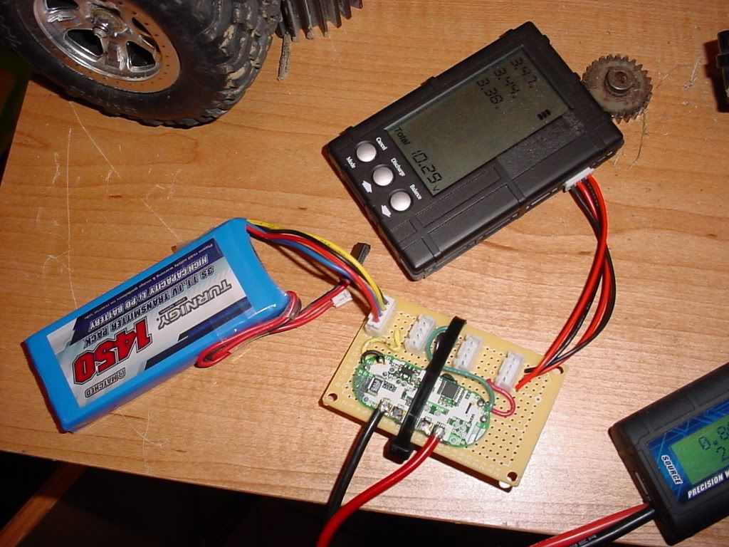

First picture shows an overview:
I have attached a PCB that I robbed from an old PDA battery that used 3 Lithium Ion Prismatic cells in series.
I'm also using a cell balancer to monitor individual cell voltage. This is a good accurate way to see what the PCB is doing with the pack, since I didn't have actual specs for this PCB.
I'm also using a watt meter to track how many amps our load is.

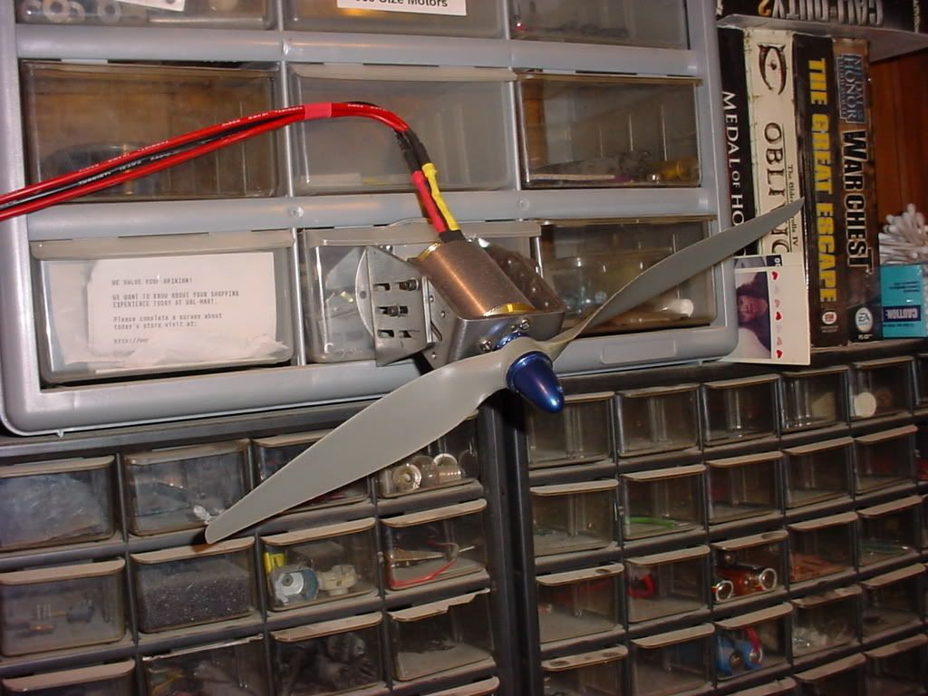

A Mamba Max Pro is powering a Prop attached to a brushless motor. (Makes for one heck of a fan too...........LOL)
I'm using a servo tester for speed control on the ESC.

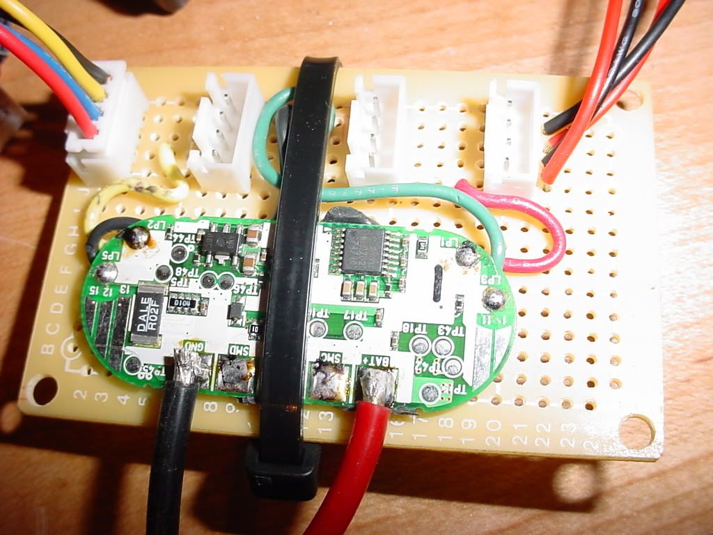

Here's a closeup of the PCB. I have attached to a printed circuit board, 4 female JST balance connectors. This will allow me to attach up to 4 packs in parrallel, for plenty of runtime on whatever the circuit is going to power.

Love the prop cooling fan..very creative. It must throw a lot of air

Thank you.
It does REALLY throw alot of air if turned up. I usually don't turn it up that far though. LOL

Ha ha I've got a fan setup like that . It's scary at car motor kv's.
