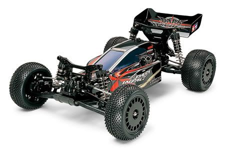

HI!... Anyone here running a Tamiya "DARK IMPACT"?
I just ordered one a few days ago and it should be here in a week or so.

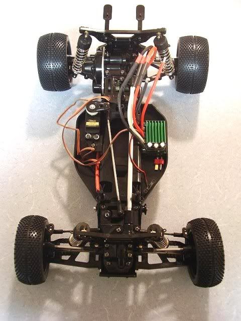

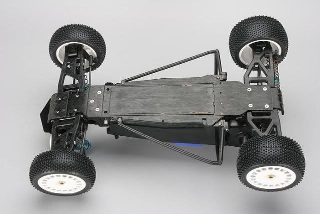

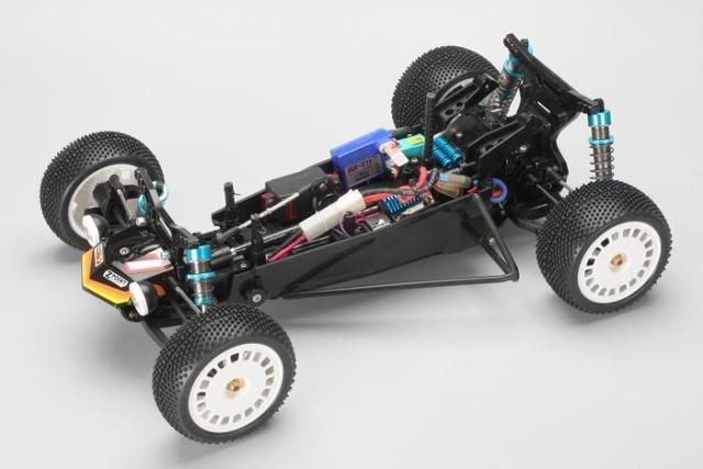

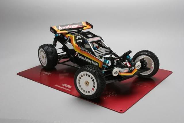

1st off I'll be doing something a bit different with my DF03. I'll be building a custom DF-03 "HORNET". Kinda combining old school with new school. Here's a few pics of what I'll be doing :
http://i361.photobucket.com/albums/o...g?t=1267676774
http://i361.photobucket.com/albums/o...g?t=1267676785
http://i361.photobucket.com/albums/o...g?t=1267676813
The guy who built the original prototype is in Japan. He has been very helpful in providing me with info on his creation.

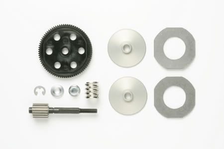

- TAMIYA slipper clutch. (already bought)
http://i361.photobucket.com/albums/o...g?t=1267677026

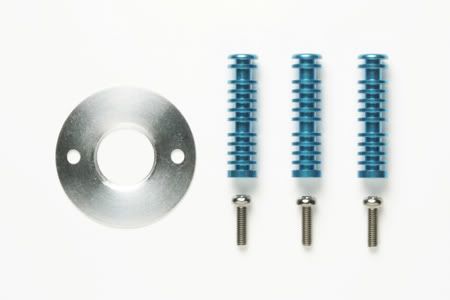

- TAMIYA heat sink. (already bought)

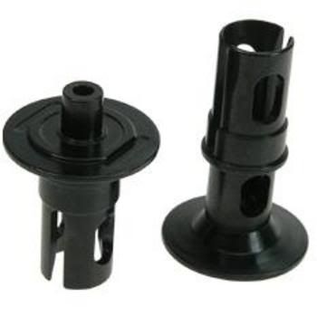

- 3RACING front/rear steel diff shafts :
http://i361.photobucket.com/albums/o...g?t=1267677366

HI!... Well I picked up my slipper clutch and started modding it already! LOL! I still want to run my M0.8 gearing set-up. So I took the gear shaft from the slipper clutch kit and drilled a small hole in it to accept a dowel pin. Then I simply modded a TRAXXAS slipper clutch and mounted it. Turned out pretty good. Sorry for the crappy pics, old digital camera.
http://i361.photobucket.com/albums/o...T/HPIM1907.jpg
http://i361.photobucket.com/albums/o...T/HPIM1908.jpg
