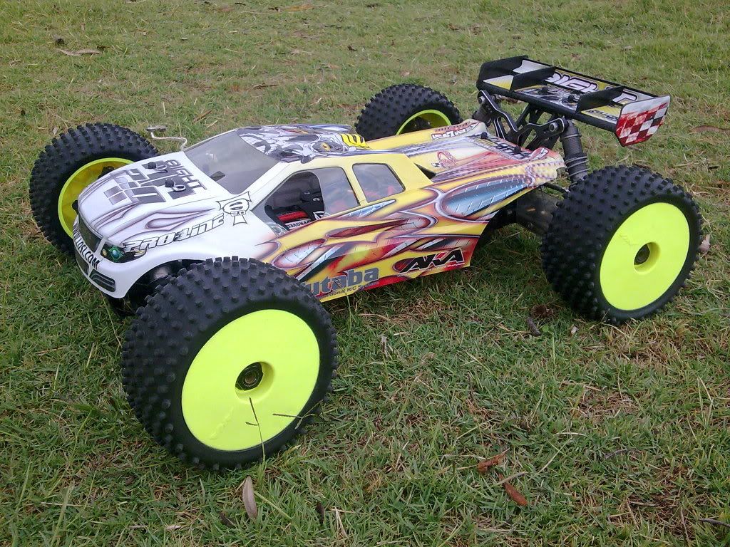

jas21373 04.14.2010 10:26 AM
this is my Losi 8t 2.0,MMM v3,neu 1515/1y,4s 5400mah ,futaba bls452 servo,smart diffs front and centre,heaps of hop-ups
http://i296.photobucket.com/albums/m.../Image0122.jpg
itbvolks 04.14.2010 01:12 PM
That thing looks killer!
Little too much tire for me personally but the paint is fantastic! Looks low and fast!
What lid?
bryan 04.14.2010 01:27 PM
"lid" appears to be factory. with a very cool paint scheme

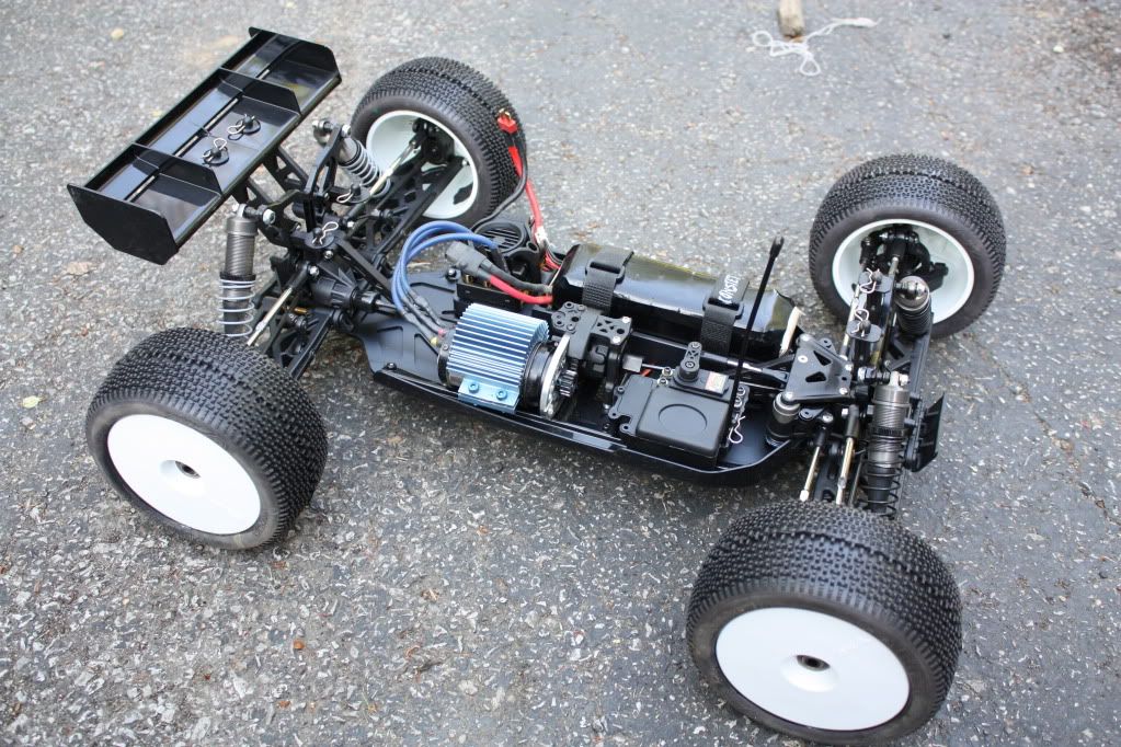

cadima 04.14.2010 10:33 PM
Well, threw one together today. My fastest build no doubt..clean and I didn't have to make any custom parts which is new for me! Only thing I had to modify was shaving off one of the screw bosses from the dirt guard that intefered with the motor, and I milled a slot under the battery tray to route the ESC wire to the Rx box. Trying to make the opening race at the local track this weekend. Aside from the lack of metric hardware on these Losi's, I get the feeling I made the right call.
http://i116.photobucket.com/albums/o...a/IMG_2608.jpg
jas21373 04.15.2010 05:05 AM
What lid?
its a factory lid .....and that great paint job is a body wrap by Fullassult.
tyres are GV tires thats what we use here for grass tracks,they hook up real well.
