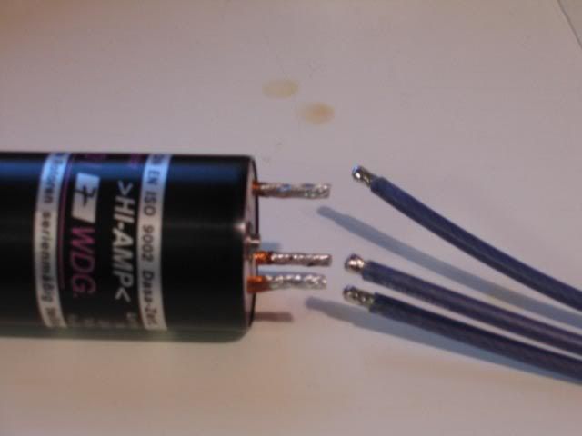

1 - the motor has three thick copper wires coming out of the back for connection to the ESC. Is this motor designed only for a direct solder connection? I also bought the 3.5mm connectors, however they don't seem big enough for the copper motor wires. I did a search on the board, and there seems to be a mixed opinion on direct solder vs plugs....

Also, Serum can you descrive how you would actually do a direct solder connection? Here's a pic of what I'm trying to join...
http://i19.photobucket.com/albums/b1...3/IMG_3965.jpg

Serum 03.29.2006 12:29 AM
Strip the wires from the controller a bit longer, then solder them together nicely and cover them with shrink.

I will recommend getting copper tube, from hardware store, and cutting 3 10mm long sections from it. Put motor wire and controller wire inside the copper tube, crimp it and solder after together. You will get connection with good conductivity and strong to wistand vibrations and possible high temperatures.

The 5.5mm gold connectors are rated at 200amps continuous - thats about 3 times more than standard Deans plugs. Personally I prefer plugs as its easier to reverse the motor direction, and it will be much easier to run the controller/motor with a different controller/motor in the future.
