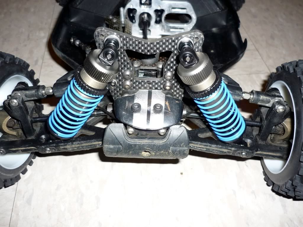

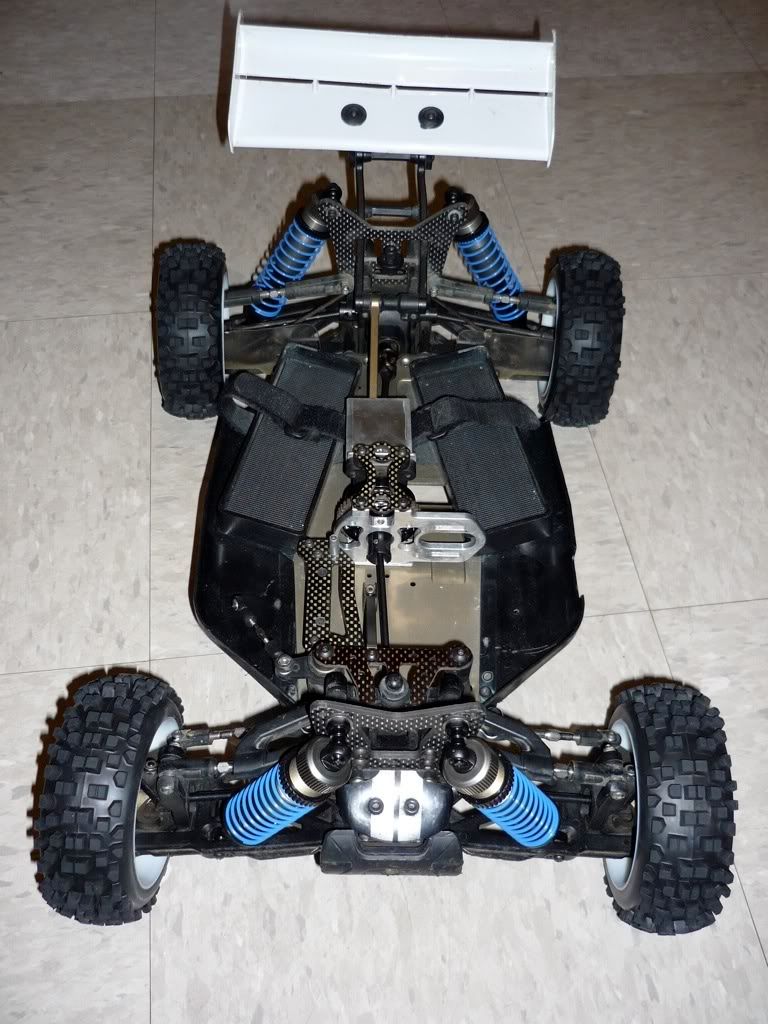

Here's the big bores mounted on my X1. The lengths were just about the same as the stock shocks, but I needed to do a few things to get them to fit. The spots where the lower ends mount had to be shaved a little bit to allow the larger captured balls to fit. Also I needed to add a small spacer on the front shock standoff so the spring and upper a-arm had enough clearance. I'm starting to think now I should have maybe used the stock 30wt oil, but I'll have to see after I get the buggy running.

Bondonutz 05.09.2010 09:40 AM
Looks good, one thing tho ?
Whats going to keep the top of the shock from popping off the mount ?
simplechamp 05.09.2010 10:32 AM
The rear are held on with a nut and washer. The front standoff screws didn't stick out long enough because of the extra spacer I had to use, so that is just a temp setup until I get longer screws. Or I might just switch to using two shorter screws, one into each side of the standoff.
Bondonutz 05.09.2010 11:24 AM
OK, Just checking. Wanted to make sure you knew there might be problem w/it as is.
