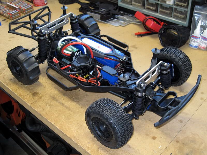

I saw some great looking mods and builds in the main Slash 4x4 thread and have a couple of questions: i want to upgrade my shocks and have been looking at the ProLine Powerstroke shocks. can anyone tell me how they are? how do they compare to the Traxxas shocks that come on the PE? or, even better, i saw how guys are using losi 8ight shocks. that looks awesome. where can i get these aluminum plate adaptors shown in pic? someone said TGN but i looked everywhere on their site and could not find them. can anyone help?
http://i471.photobucket.com/albums/r...ightshocks.jpg
Bondonutz 05.08.2010 09:13 AM
I have 2 PE Slashes and absolutely enjoy the hell out of them ! I have yet to bash mine ben running them on the track w/1509 1820KV and 3s.
I have the stock PE shocks on one and have zero complaints, no leaks and their smooth and work very well. On my other I have the brackets and losi 8 shocks as you mentioned.
You can get the plates here from a fellow member;
http://www.nuibe.com/rc/slash4x4/shock_towers/

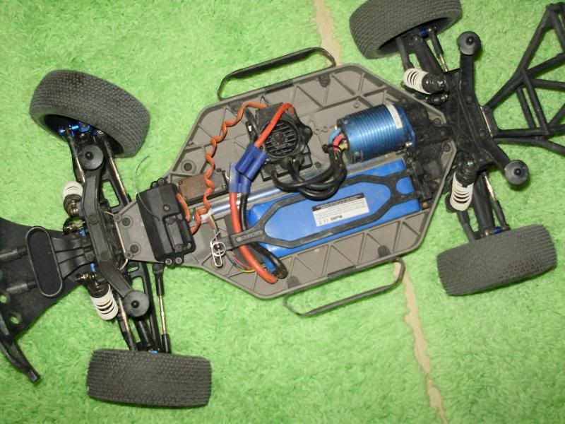

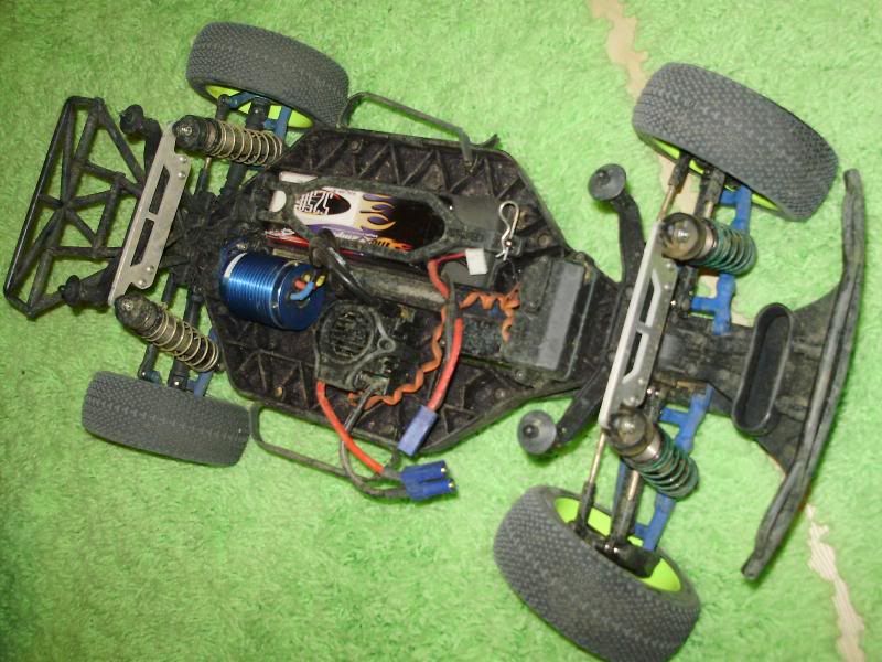

Bondonutz 05.08.2010 03:53 PM
The 1590 2Y 1820kv is geared 54/18 and is a ice cold running ROCKET !
If the track or if you bash and the surface is really rough and choppy/large jumps the Losi shocks really shine. If it's a pretty smooth track or you bash on concrete you'll find it hard to notice a difference.
PE 1509 2Y
http://i88.photobucket.com/albums/k1...S/P5080001.jpg
Almost a PE, w/1509 2Y
http://i88.photobucket.com/albums/k1...S/P5080002.jpg

Yeah, kinda threw me for a loop myself. I bought one of those motors from NEU's web special 4-5 months ago for 110.00 and decided to try it in a 4wd Slash and wadda ya know ? Despite Brians calc the RPMs have to be higher for it to run so cool ? IDK everything about all the the little details but it works especially well for the application. Enough so, that I bought another motor last week for the other Slash to replace a 1512 I had in it. After 5 hrs hours or so of brutal driving in todays heat of 91 today in Fl, the motor was barely 100degrees, ESC fan NOT on (M.M.M.) and the Lipo was 98dgerees (MA & Zippy 30C 3s 5Kmah) I ran 4 packs through one truck and 3 in the other to LVC and temps were the same across the board. Couldn't ask for more ? :yes:
I'm gonna put that 1512 1700kv in my Ebuggy and try it on 5s now !?
