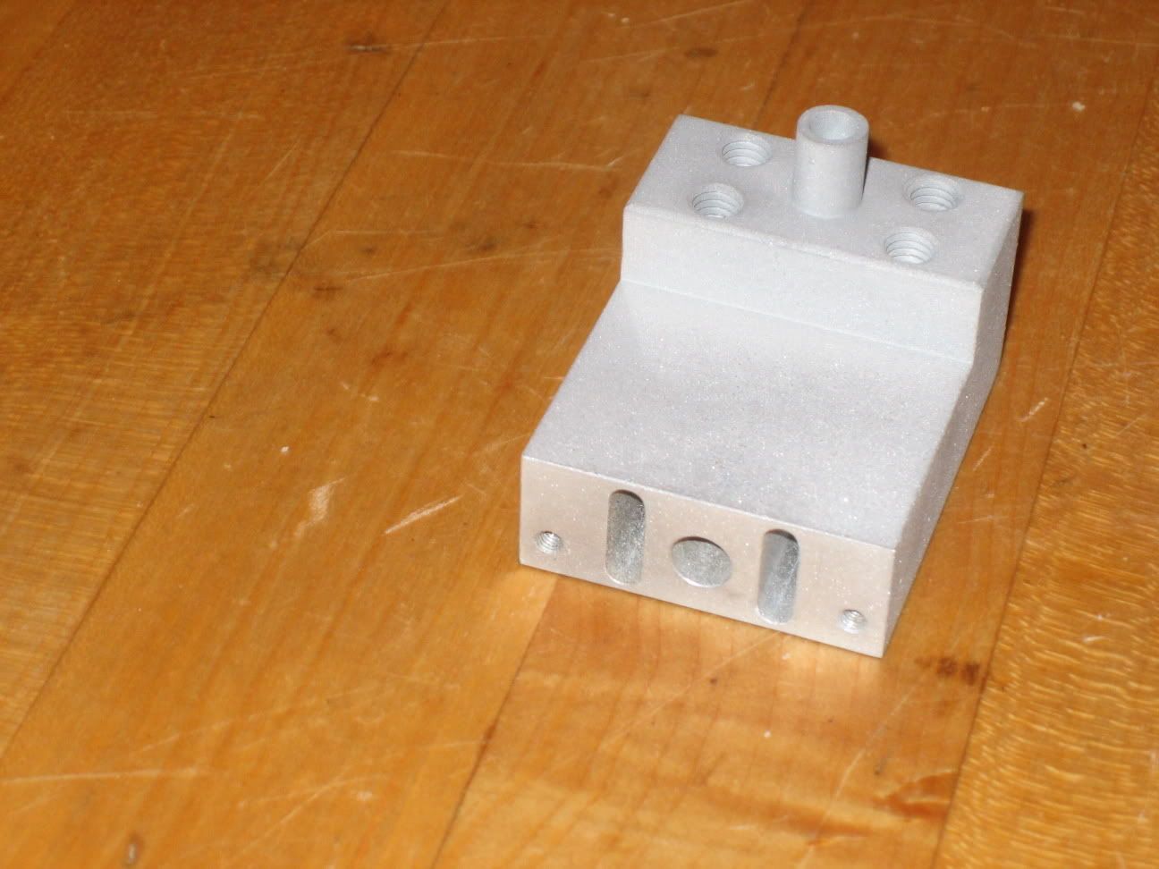

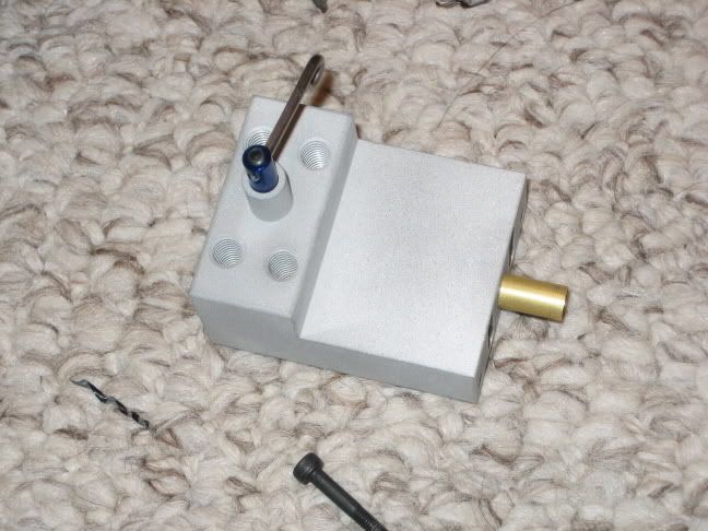

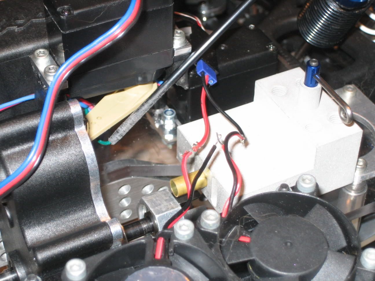

http://img.photobucket.com/albums/v7...c/IMG_0904.jpg
http://img.photobucket.com/albums/v7...c/IMG_0903.jpg
http://img.photobucket.com/albums/v7...c/8fc27dd2.jpg
http://img.photobucket.com/albums/v7...c/10881a4a.jpg
http://img.photobucket.com/albums/v7...gsfor-rc/3.jpg
http://img.photobucket.com/albums/v7...ingsystem3.jpg
http://img.photobucket.com/albums/v7...kingsystem.jpg

I dont see the way this thing works. Please elaborate or post a completed pictured, i'm very much interested.

Superemaxx89 03.30.2006 11:34 PM
-Y-harness the shifting servo with the esc into the throttle channel. This now makes the shifting servo a throttle servo.
-Program your controller to be foward only (no brakes). All BK controlls can be programed so.
-Tell me what chassis (or where your servo is located) and i'll create the proper linkage for your setup. This now makes your throttle servo into a braking only servo.
-install the braking module by either using the 4 M6 holes already tapped (specifically for torpedo/racebomb), or install a clamp. Specify your chassis and i will tell you what you need.
-You will lose the shifting servo as for the braking servo takes the shifting servo spot, but there are ways creativity can get around this (though it is basically impossible with stock chassis).
-You will lose reverse unless you can get creative. The only way I can think of gaining reverse is installing an optidrive, which doesn't seem too hard.
-I find that shifting and reverse are the one things I do not need. Whether bashing or racing (this module weighs about 75grams ---1lbs=454 grams---). The main purpose of this mod is to:
A. Remedy the 9920 braking deficiency
B. Increase the longetivity of your batteries, motor, and your esc.
C. One of a kind product for one of a kind truck!
Thanks
