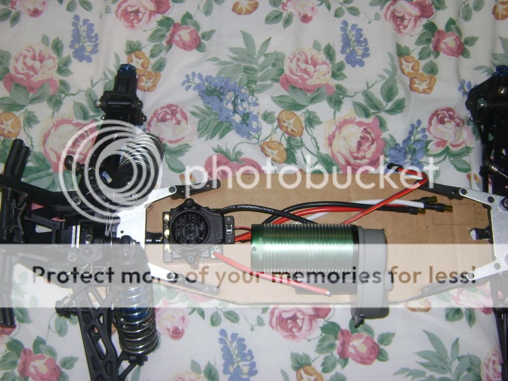

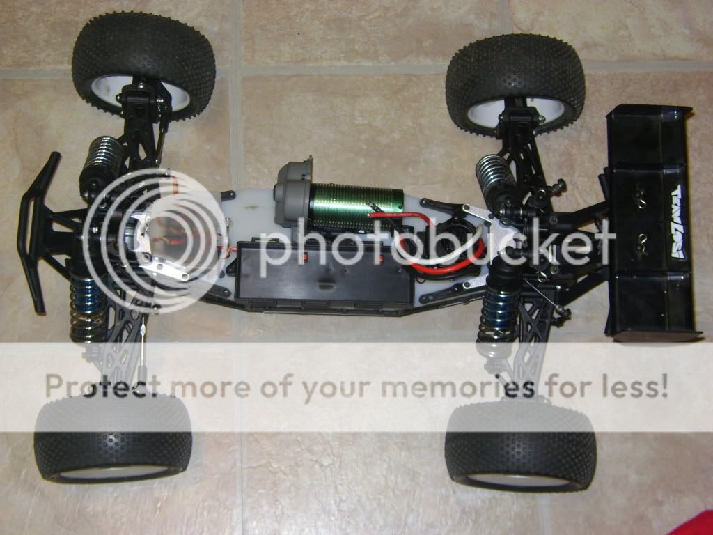

Hey guys i figured i'd put a build thread over here to...so here it is
I started out mocking things up with a cardboard chassis, my MMM last weekend and just picked up my Castle/Neu 1520 1Y today
Now i just need to wait for my plastic to come in to make my chassis plate and bracing out of, and also still need to order batteries from HK(probobly next month)
But this is how it's sitting now:
http://i703.photobucket.com/albums/w...n-Mc/002-3.jpg
http://i703.photobucket.com/albums/w...n-Mc/003-1.jpg
Feel free to ask questions
-Austin
P.S. sorry if this is the wrong section...didn't know were to put it

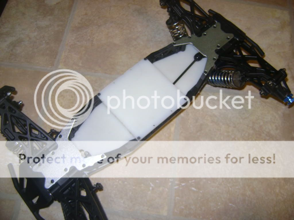

Losi LST2 05.20.2010 09:43 PM
UPDATE TIME!..
My Nylon plastic came today.:
http://i703.photobucket.com/albums/w...oreplastic.jpg

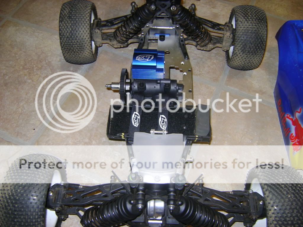

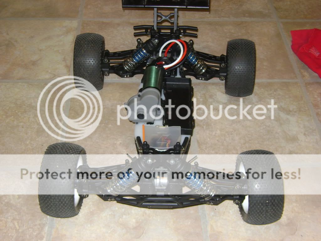

Then i went on a cutting expidition and cut my top plate to shape aswell as my bottom plate:
http://i703.photobucket.com/albums/w...sistopveiw.jpg
http://i703.photobucket.com/albums/w...bottomveiw.jpg
This stuff is ALOT stronger then i thought it would be....just to see how strong it really was i stood on it(after it was installed like in the pictures above..it held my without even thinking about breaking...barely even bent....and now you may be thinking this isn't that amazing..BUT i weight 210pounds...i'm not a light kid :P

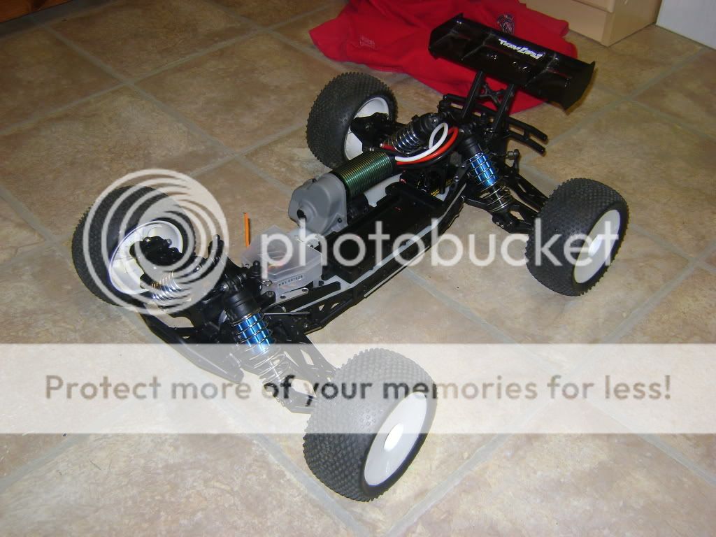

Losi LST2 06.01.2010 09:47 PM

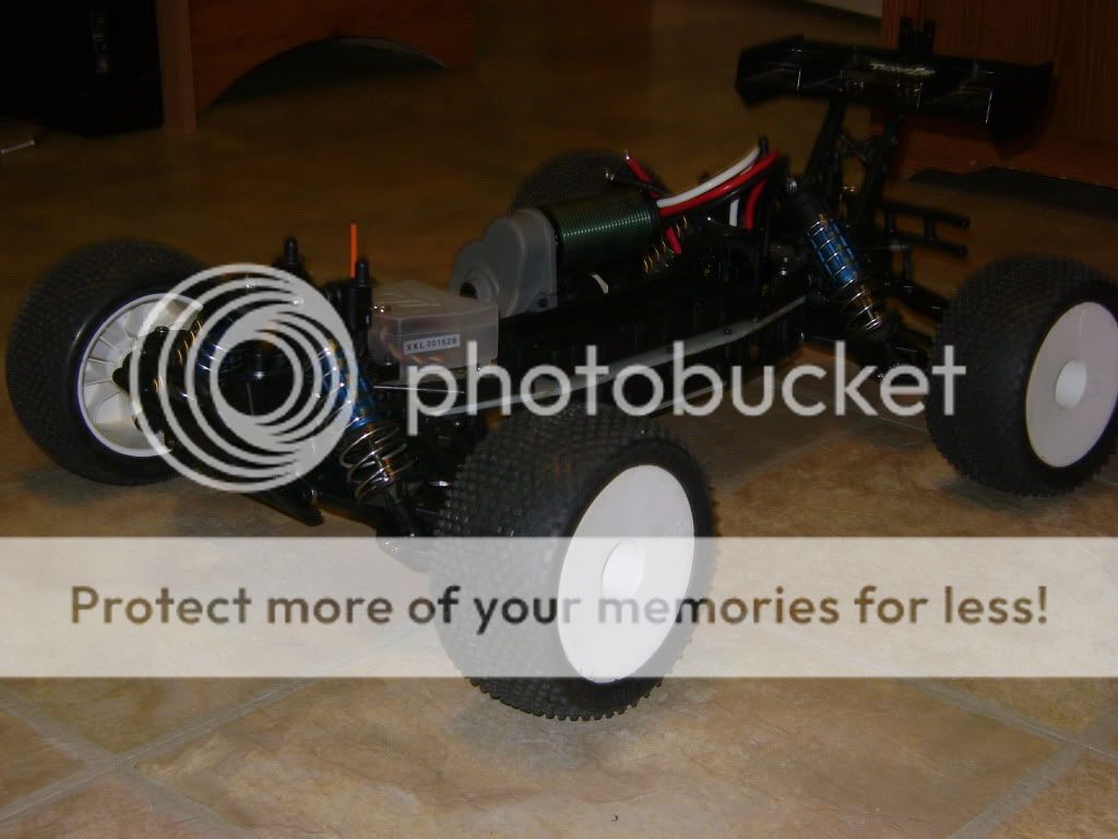

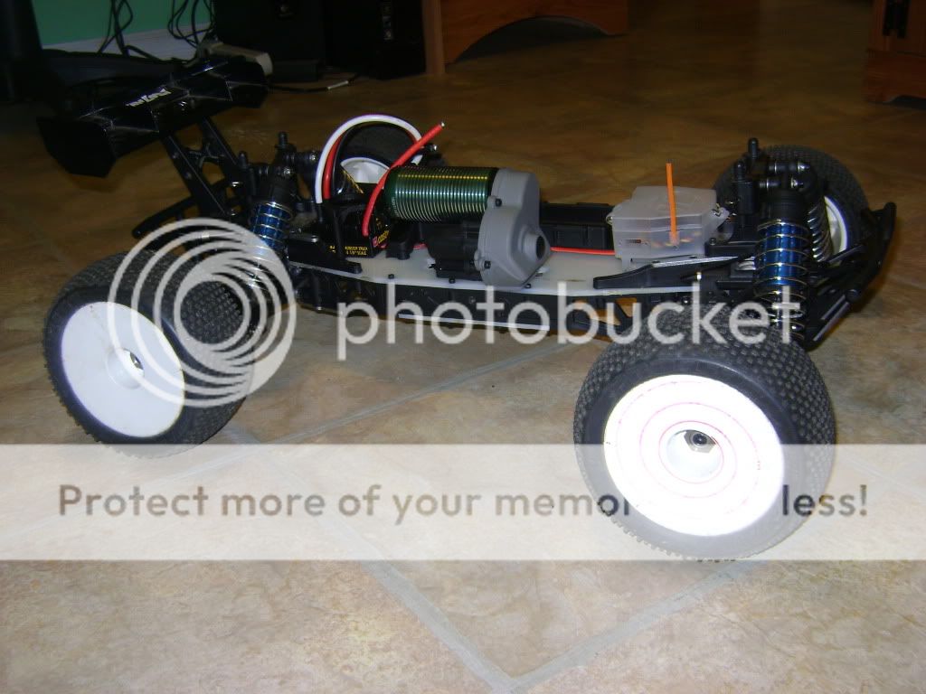

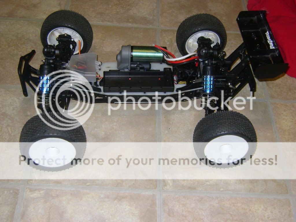

Guys after the long wait i've got some good news!!
IT'S DONE!!!!!
Here are the pictures of it in it's completed form minus the batteries that i am still waiting for from HK:
http://i703.photobucket.com/albums/w...ld/lstdone.jpg
http://i703.photobucket.com/albums/w...d/lstdone2.jpg
http://i703.photobucket.com/albums/w...d/lstdone3.jpg
http://i703.photobucket.com/albums/w...d/lstdone4.jpg
http://i703.photobucket.com/albums/w...d/lstdone5.jpg
http://i703.photobucket.com/albums/w...d/lstdone6.jpg

Bondonutz 11.23.2010 05:31 PM
Updates
Trans holding, hows it drive ????
Losi LST2 11.23.2010 05:46 PM
Trans held great but the chassis was starting to flex way to much...so I'm in the process of putting it back to the regular LST chassis..
Before i took it apart it was running awesome but jumping it was a pain because of chassis flex...it would wheelie on demand on asphalt and did pretty good on the track.
I'm low on cash right now due to Christmas and all, so it probably wont be done till early next year unfortunately...although with winter here and already over a foot of snow on the ground it doesn't matter to much anyway
Bondonutz 11.23.2010 05:52 PM
Ahhh, I was thinking that plastic is strong but flexable, I'm thinking of copying the layout but will either this:
http://cgi.ebay.com/ebaymotors/REAL-...Q5fAccessories
or CF ??
What voltage you ben running with that 1520 and trans ?
BTW, did the XXL center axles lenth reach the trans out drives OK ?
Thanks
Losi LST2 11.23.2010 06:24 PM
I've been running 6s in it with the 1520
And the XXL axles fit perfect where the trans is currently....they are the reason i offset the trans because they were to long to fit with the trans in the center of the truck
