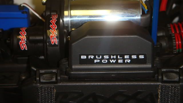

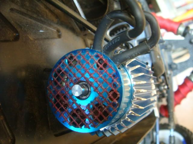

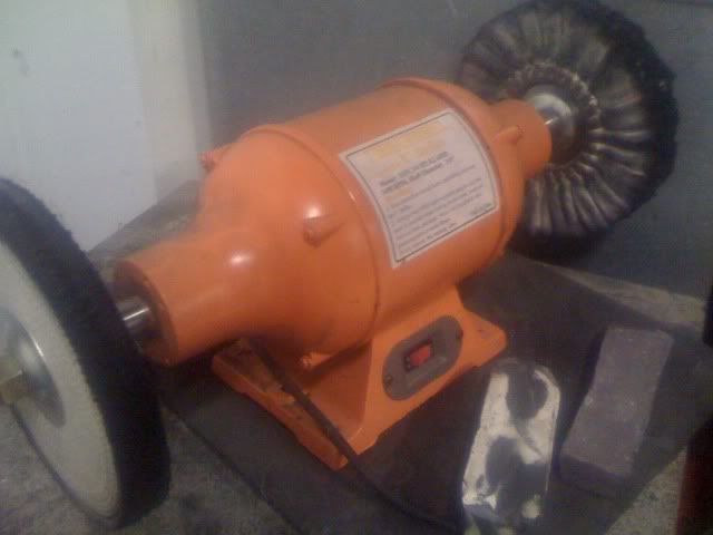

bruce750i 05.28.2010 10:53 AM
Dual 6" buffing wheels on 3/4hp @ 1750rpm help, but it still takes time sanding up through the grits.
Steal wool comes in different grits also and is good for bends and elbows.
Sometimes I use a obital sander upside down in a vice for flat surfaces.
Is that a TVP chassis?
http://i300.photobucket.com/albums/n...h_e45056c2.jpg
http://i300.photobucket.com/albums/n...h_DSC06405.jpg
http://i300.photobucket.com/albums/n...h_DSC06602.jpg
