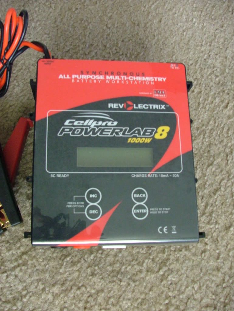

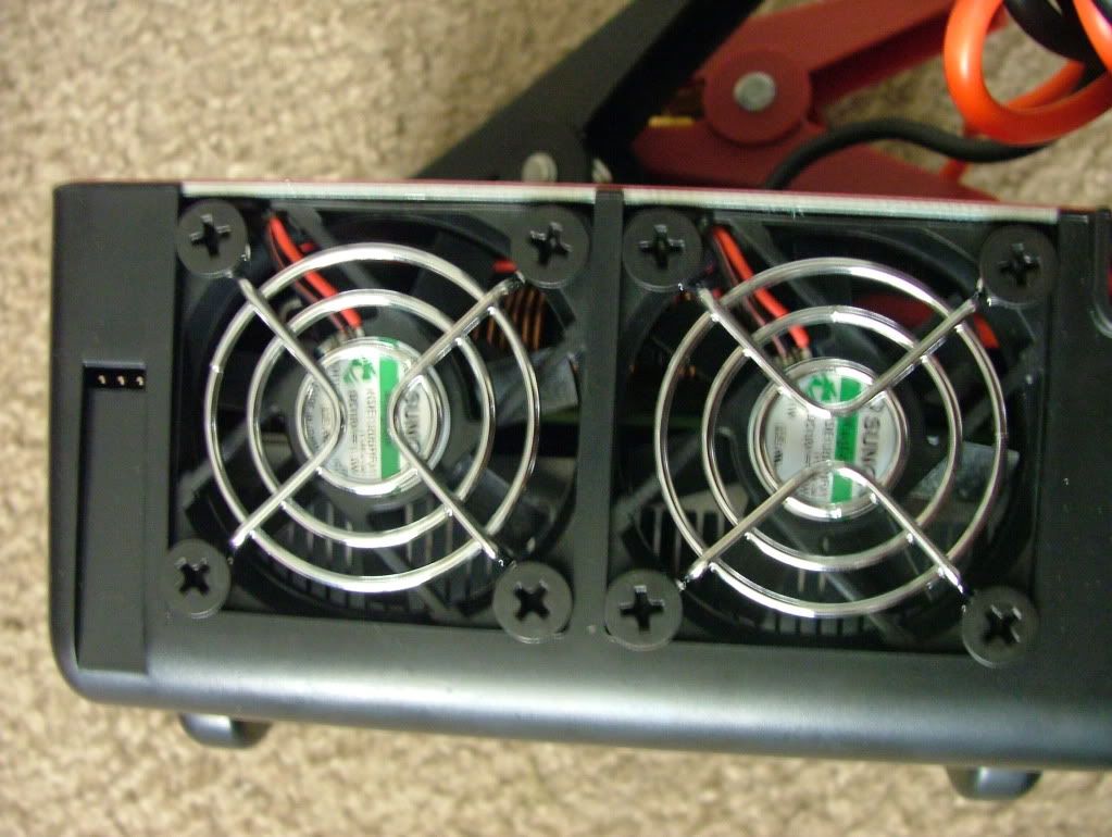

WhataNut FMA PowerLab8 1000W charger
I finally received the WhataNut Charger by FMADirect. It's the PowerLab8 model and it has been out in the field for a bit by Beta Testers.
There is not much to say yet about this charger, as they didn't send the usb adapter with the shipment.
I did get to charge my A123's at 30A! Even cycled them once at a discharge of 30A. It's going through its paces now in my garage. AcePow and Enerland lipos going through a storage charge right now. In unbalance mode, I can charge the A123's at 20A and in balance mode at 30A. However, I cannot do 6s unbalance. But no biggie really. At 30A, the 6s A123 pack is charged in less than 7 minutes. I did some regenerative dircharges. Nice feature to have as the charger doesn't get hot from waisting your mah into heat. My car battery got a nice workout. Next investment is a DC power supply with some big balls. More details will follow later on.

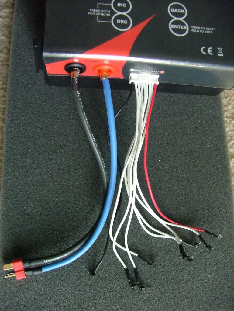

What are you doing with the Balancing plug? are you making your own? did you take the small wires out of it's original plug adapter? I've never seen a balancing plug with all the tiny wires pulled out like this, unless you did this yourself? what are you doing with those wires at this point in time? Nice Pictures.
snellemin 07.14.2010 03:00 PM

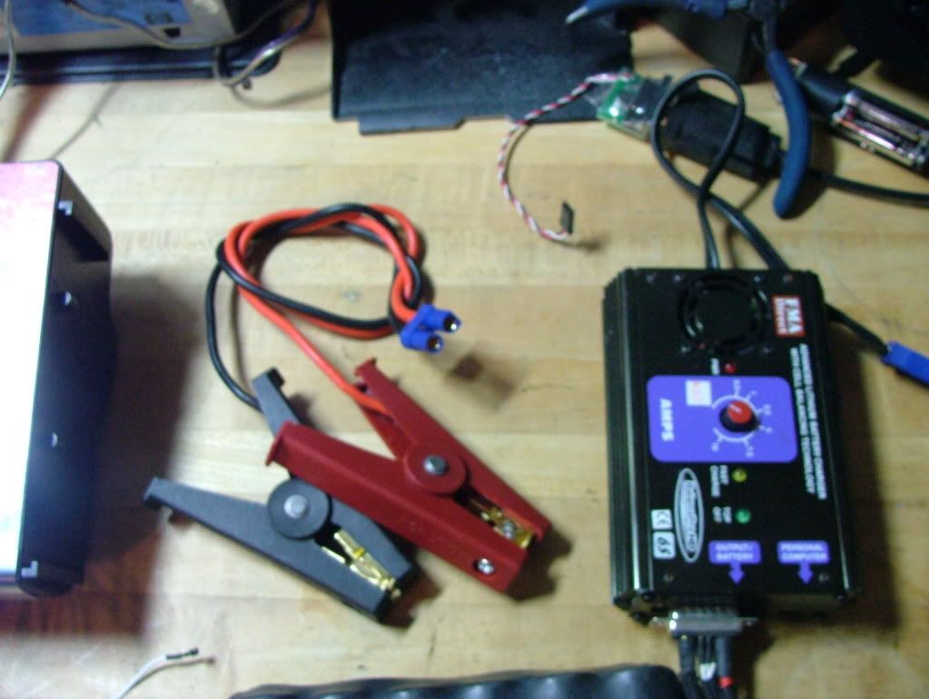

I took the wires out from the balance board. I don't feel like buying just the wiring harness either. So I took them out and soldered on the pins, which I just plug into my balancing ports on my batteries. Easy enough for me and I don't need adapters and whatnot. I'll post pics of my batteries balancing ports later on. I use PC connectors. I also made a power output cable with EC5 connector for when I do parallel packs. I'm just waiting for the usb adapter to play with the custom settings. I just got me an HP server 47A power supply. I just need to figure out the pinout to turn the sucker on.
Awesome,
is that a 12volt or a 24volt power supply. I know these chargers can utilize both types. But the 24volt is required if you're goiong to charge say, a 6cell or larger battery at 6c or 30amps. I got lucky, and my 12volt power supply has enough watts to power my charger to charge my 3cell at the full 30amps. if I was charging any more cells, I may have to charge at a lower amperage. some of what I've just said was the most difficult for me to learn and understand, but I understand enough to make it happen now, and that's what counts.
By the way, your subject says Whatanut, before the charger model, and it looks as if that has something to do with the charger model. but I've never heard of whatanut before. can you please tell me what the word "whatanut" is related to?
PS. You must really understand electricity quite well to be able to configure your own balancing plugs. any chance you can document your procedure. in other words, pictures followed by detailed explanations of what each wire does and how it balances your batteries. I know many people understand how to do this, but I come from Nitro background and know very little about electricity. But I want to learn and understand as much as is possible. I hope you will do this. This thread would be a good place to show this process of making your own, or configuring your own balncing port plugs for certain lipo or other types of batteries that anyone may want to balance. I find this to be very important and extreemly valuable information. I hope you can do it :-)

Originally Posted by snellemin (Post 373208)
I took the wires out from the balance board. I don't feel like buying just the wiring harness either. So I took them out and soldered on the pins, which I just plug into my balancing ports on my batteries. Easy enough for me and I don't need adapters and whatnot...
I do something similar, except the end of the balance wires terminate in a pin header (pic and pic). This allows me to use any balance plug with the standard 0.1" spacing. The only exception is some older MA packs I had which use the Hyperion pinout; for these, I just resorted the wires.

The connectors are just pin headers that BrianG uses, but mine are just indivually cut as I use anything from 2s to 6s. This way I don't need to make a bunch of balancing harnesses. And now I can charge my two 4s packs as 8s with serial adapters. Lots of time saving compared when I use to charge them in parallel at 10A.
The FMA pinouts are the same as a blinky, which I also use at times.
