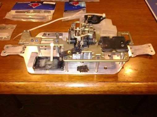

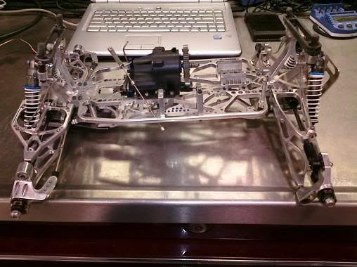

i have a full blown ue supermaxx. it has a vbs set,racerx,spider 6s,6mm axles, ue shocks,strobe limiters etc... i have a jt racing chassis for it. i am looking to put one of mikes center diffs with the brushless motor mount.
can anyone tell me which one will fit?
can i take off the top plate and just put traxxas 7075 turnbuckles or pushrods running from the center diff to the vbs top mount i have seen it done with other trucks.
also i am looking for a set of sun 7s rims if any one can lmk where i can find a set of those or if you have a set you can sell me or trade me.
here are some pics of the truck right now.

here is some of my extra parts i have. i am keeping the other racer x kit for a future build with the thunder chassis. i am also keeping a set of towers.
http://s758.photobucket.com/albums/x...ejpeg950tg.jpg

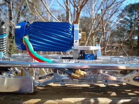

plettenbergs 07.17.2010 12:42 AM
check this out...UE THUNDER WITH RCM center diff!!
uses two thunder rear cvd's for centers!!
http://i302.photobucket.com/albums/n...s/DSC05490.jpg/http://i302.photobucket.com/albums/n...s/DSC05491.jpg
http://i302.photobucket.com/albums/n...DSC05496-1.jpghttp://i302.photobucket.com/albums/n...DSC05486-1.jpg

plettenbergs
sweet truck. i am probrably going to use that on my thunder chassis in my next build. also another thing sweeeetttt knuckles.
