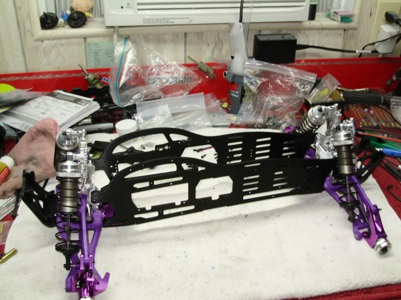

Ok, seems that these build threads are getting fairly common so I'm gonna try to keep mine fairly short and sweet (like me). I like the rugged good looks of the raw aluminum and black but again seems to be the norm for everyone elses other than subtle differences.
Heres the front assembly, I went with the obvious Fast Lane Machine stout aluminum diff case/bulkhead and filled it with the HPI Bullet Prof Diff and hung RPM arms and HPI goodies on the end. I was going to cut up and make some LST2 axles work because the ends of the axles where the hubs attach are mucho stronger due to design but I figured I'll do that at a later date. Still waiting for the HPI Titanium Turnbuckles for steering.
I bought the Desert Boy 17 Chassis and will more than likely go with it for now. I bought some 3/16" 7075 plate and was cutting my own but found myself fustrated and just bought one instead.
Cutting two layers of the 3/16" with a jig saw is slow going and eating blades, It's taken several hours just to get the chassis outline cut out , I still have to cut the the holes, drill holes and file all the edges real pretty. I figure I'll have another 10-12 hours to go yet. My design is much different and will allow the batterys up front were they need to be. It's also a 20" WB chassis were as the DB17 is 18-1/4". I have several options.
Still haven't decided to either try to mount a Baja 5B roll cage or go with a large scale body ?
I will be powering this build with either a NEU 1527 or a 1521, not sure just yet. Test's will determin which will get used and with what voltage. Will be running maximum voltage of 8s and 10s, The ESC of choice is still up in the air ??
If I over looked something or you have a piece of advice please chime in.
Jeff

Finnster 07.19.2010 08:52 PM
Interesting to see you went w/ the Savage with all the FLM parts and LST shocks after all that in the other thread w/ Linc and the comparisons to the LST. Thought you got talked out of it.
Otherwise I am about as far as you are w/ my reconstruction. I have a 1521 and will use 8-10S whenever CC gets the HV ICE done, and FLM finishes up their 1/5 scale TVPs so I can take a good look at them. Want to have that w. Mike's UCD mount also.
I do like FLM's tiebar for the steering rack. Its worth looking into to complete the look and also gives good performance.

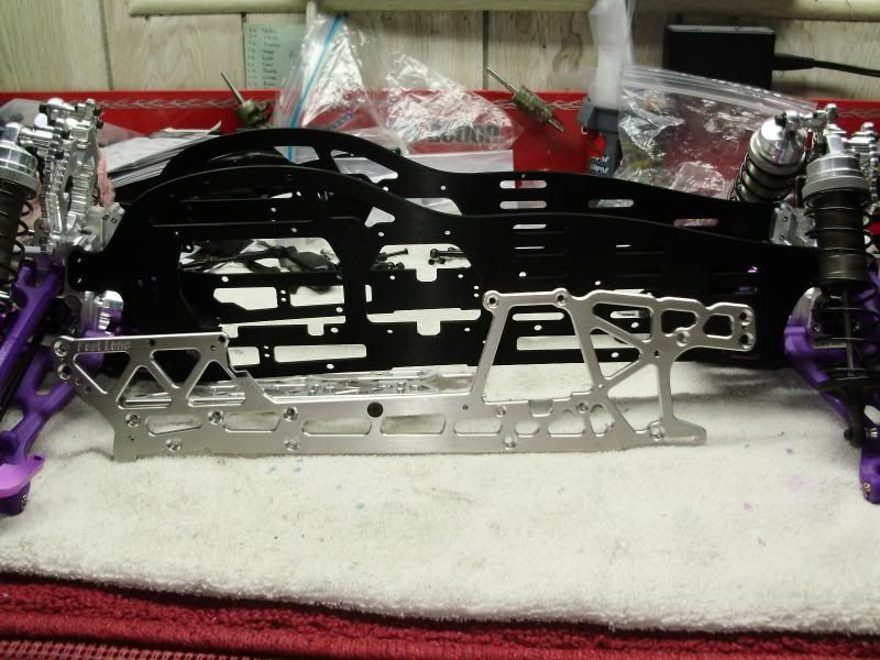

Bondonutz 07.21.2010 09:19 PM
More Pics
I finished assembly of the rear clip this evening and just slapped on the TVP's with a couple screws to get an idea how this thing will sit.
http://i88.photobucket.com/albums/k1...E/P7210024.jpg
Heres the Fast Lane Machine Tranny/forward chassis that is Savage XL in lenth, the DB 17 is about 2-1/2" longer
http://i88.photobucket.com/albums/k1...E/P7210025.jpg
Now that I can really take a look at this chassis I am a little dissapointed theres not much that can be done to switch componants around for better balance. BUT, with a couple light weight packs in series the balance shouldn't be to terrible bad ?
I'm making mental notes for when I finish my own chassis, all the things I dont like or wished it had should be incoorperated into it. I need to find something better to cut the Aluminum with tho, the jig saw sucks.
Finnster 07.21.2010 11:49 PM
Is it backwards? Looks like the steering is in the rear.
In order to balance my XL, I had made side mounted batt boxes that were just slightly F biased. With 8-900g of batts, the balance is very near 50/50

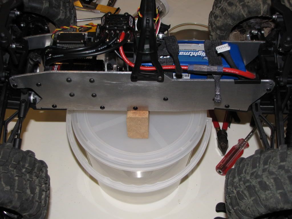

_dV 07.22.2010 04:26 AM
Its the right way round. Motor is in the front for the DB chassis and you can see the cutout for it.
That 7075 Al alloy must indeed be hard stuff. Only used 2 blades cutting my build with a jigsaw through 3mm 5083 H321.
Finnster, your comment made me wonder about my build which is XL length. I'd only just got it into a runnable state and hadn't checked the balance point yet.
It's 1/2 cm forward of center :smile: and most of the cutouts in the TVPs will be in the rear so it will move a touch more forward. Battery is 5s 5800mAh (727gm).
I reckon bondo's build should have a pretty decent balance as long large packs aren't used. The flightpower pack i use is quite short(145mm) which allows me to keep it forward ..there should be plenty of space in the DB17 to do the same.

Jahay 07.22.2010 04:49 AM
bondo i think you are bring a little worried over the weight distribution un necessarily. Fit it all out and then see what you need to do.
Having the motor so far up front and having the extra length of teh chassis really does keep the weight quite well distributed even with my 6s 6500mah lipos in the back!!!
With the right sized wheels air control is great too for jumps... I love that flm forward tvp set..
I know what you mean about there not being much room to play with moving stuff around, but there is plenty of beef on the tvps to cut your own holes.
